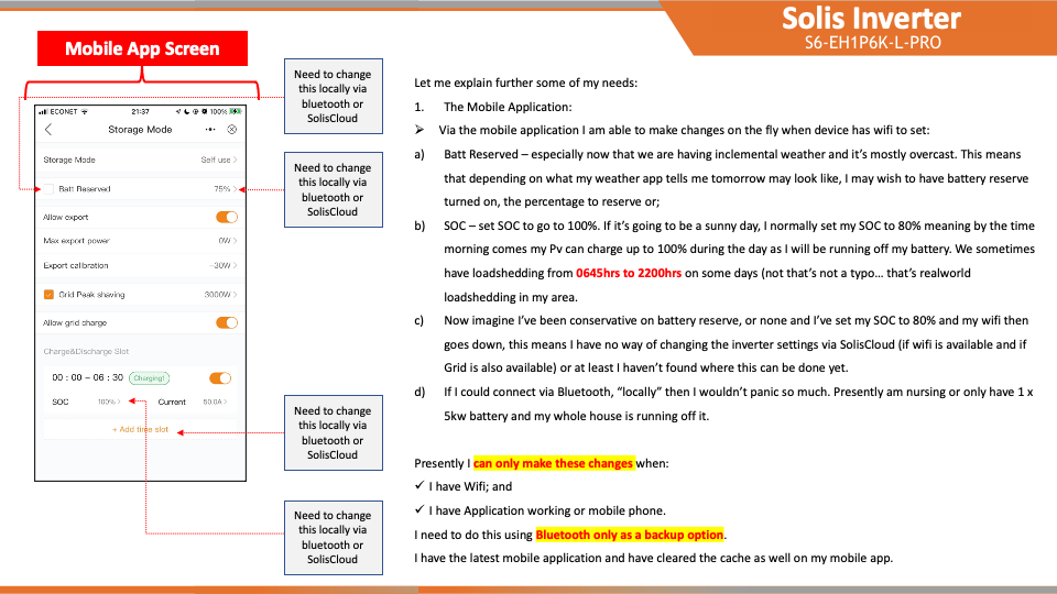

April 6, 20251 yr I seem to have read one of the reviews that the reason Solis has no LCD display such as the Deye/Sunsynk is to have "one less thing failing" on the inverter as an argument. This means one can only tweak Depth of Discharge changes or Charging parameters using the mobile app or wifi.I have a Solis S6 6Kw 1p Pro inverter and had an instance where my wifi was down. I was unable to connect to the inverter to see the flow-chart using bluetooth connectivity. Firstly, my wifi bundle ran out and I was unable to check how my Solis S6 was performing "locally" using bluetooth. Once I recharged with my Internet Service Provider, I had an issue where there was no internet connectivity and was also unable to check what was going on. Fortunately the inverter continued to function without issues.If something had needed to be done or tweaked, I would have been stuck as an End-user. Am just thinking it would be good if the bluetooth worked. I did not want to unscrew the cap on my dongle and connect using a cable to my pc to check if I could connect though, perhaps this would have worked and enabled me to have access to make tweaks or get info, not sure.If one has the Advanced User Profile set up by the installer would they be able to connect locally via bluetooth, anyone with such experience or has had a need to do this?

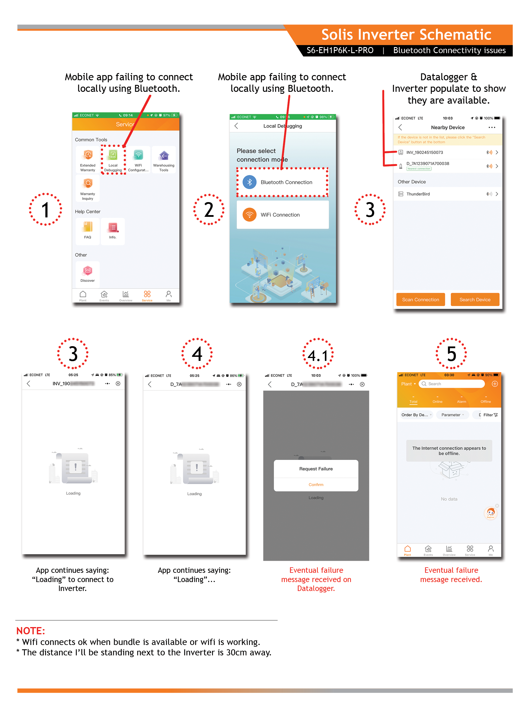

April 7, 20251 yr Author 13 hours ago, Pho3niX90 said:In short, yes you can connect via bluetooth from your phone.I personally do not use the app often, just connected to home assistant to allow realtime comms all the time.The wifi connectivity isn't the greatest, although I cannot comment on how it compares to other brands, but close proximity power isn't a wifi signals best friend. Signal is weak, but never disconnects.Unfortunately @Pho3niX90 that's not my real-world experience. Am unable to connect via "bluetooth only" to the Solis without wifi being on and with an active wifi connection.

April 11, 20251 yr Author 19 hours ago, Pho3niX90 said:You are within bluetooth range, correct?For me, wifi locally doesn't work via the app, bluetooth does.Wifi and Ethernet would be identical, just the means of broadcasting data is different, but usage is exactly the same.19 hours ago, Pho3niX90 said:You are within bluetooth range, correct?For me, wifi locally doesn't work via the app, bluetooth does.Wifi and Ethernet would be identical, just the means of broadcasting data is different, but usage is exactly the same.19 hours ago, Pho3niX90 said:You are within bluetooth range, correct?For me, wifi locally doesn't work via the app, bluetooth does.Wifi and Ethernet would be identical, just the means of broadcasting data is different, but usage is exactly the same.Am standing about 30cm from the Inverter and bluetooth shows Inverter and Dongle but20 hours ago, Pho3niX90 said:You are within bluetooth range, correct?For me, wifi locally doesn't work via the app, bluetooth does.Wifi and Ethernet would be identical, just the means of broadcasting data is different, but usage is exactly the same.
April 11, 20251 yr Author As for me, Wifi works locally as well as through the Solis Cloud web portal. It's the local connectivity in the event that wifi is down that's failing. See attached screenshots.
April 11, 20251 yr 10 hours ago, Moffat said:As for me, Wifi works locally as well as through the Solis Cloud web portal. It's the local connectivity in the event that wifi is down that's failing. See attached screenshots.Perhaps lets split the web portal and phone app.Web Portal works only via internet connection, either with wifi or ethernet.Bluetooth works only with the phone app, but also if the inverter has internet. Local (direct) wifi connection via the app doesn't work.One thing, when choosing the bluetooth drvice, you will see both the inverter, and the dongle, you need to select the dongle. Can you see them?Edit: I do remember reading in the solis review thread, that OP also had issues connecting via bluetooth, he let support update the inverter firmware, and cleared the apps cache, after which it started working. Edited April 11, 20251 yr by Pho3niX90

June 17, 2025Jun 17 5 hours ago, Moffat said:My only challenge still, is getting a way to communicate with the inverter when I have no internet using only bluetooth.Here is an step by step guide from Solis how to connect the inverter to Bluetooth. See link below.https://solis-service.solisinverters.com/en/support/solutions/articles/44002504766-s6-hybrid-series-soliscloud-app-local-bluetooth-connection-guide

June 17, 2025Jun 17 Author 4 hours ago, TaliaB said:Here is an step by step guide from Solis how to connect the inverter to Bluetooth. See link below.https://solis-service.solisinverters.com/en/support/solutions/articles/44002504766-s6-hybrid-series-soliscloud-app-local-bluetooth-connection-guideOn first installation, managed to setup the Solis as per this link. This evening I did the following:Option ASwitched off wifi on my mobile phone but kept bluetooth on (on my phone) but got the error message "The Internet connection appears to be offline"I switched of my router so no wifi would connect to the InverterThe result:Was unable to connect to Datalogger or InverterOption BKept my router off so Inverter is connected to wifiTurned on mobile data for Solis App on my mobile phoneThe result:I was able to connect to the Inverter as well as the Datalogger and also am able to change settingsConclusion:One can connect to Solis inverter using bluetooth but phone device needs to have mobile dataOne can connect to Solis inverter datalogger/inverter even if there's no wifi for Inverter but connecting device needs data and bluetooth to be on.5 hours ago, TaliaB said:Here is an step by step guide from Solis how to connect the inverter to Bluetooth. See link below.https://solis-service.solisinverters.com/en/support/solutions/articles/44002504766-s6-hybrid-series-soliscloud-app-local-bluetooth-connection-guide
