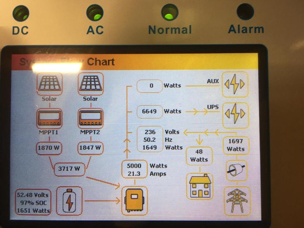

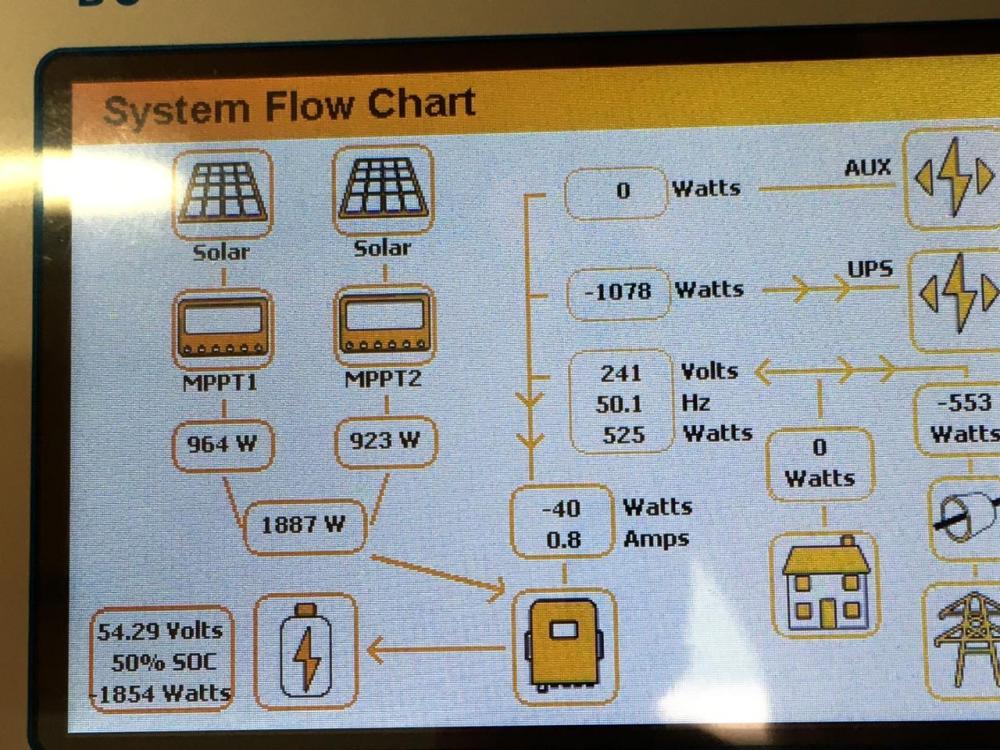

@Gooney Bird system is sorted. Minor problems eg. Incorrect CT polarity and mostly settings. Never underestimate the importance of installing the CT coil correctly on bi-directional inverters. As for the geyser and pool pump on essential side will be managed by installing a double pole relay downstream from the smart timer where geyser and pump will be disconnected during power outages and automatically reinstated when utility returns. Also swapping the 3kw geyser element out for a 2kw element.
Before and after flow diagram from the inverter. Pushing the essential loads far beyond 5kw thanks to pass-through capability.
This data below corrupted due to CT polarity being incorrect.
Edited by TaliaB
Grammar error

Just to add to what TaliaB posted in terms of the flow chart and issues encountered with my solar system, he found that the CT Coil was showing corrupt data on the system's flow chart due to it being incorrectly installed by the Electrician responsible for completing my solar electrical installation and who ultimately was responsible for final commissioning of my solar system, this despite him having been given a clear diagram of how the CT coil wires were to be joined to the CAT6E cable and exactly how they were to be connected to the Inverter.
What is also evident on the flow chart as pointed out by TaliaB where I pushed the essential load beyond 5kw momentarily resulting in the high wattage that was created momentarily was due to a communication problem with my wife as a result of her unknowingly switching the home kettle on whilst I unknowingly switched the geyser on as I was also testing the geyser at the same time that the kettle was boiling😌
As discussed by TaliaB in his post there will be further enhancements to come such as replacing my 4kw geyser element to a 2kw geyser element and also installing the double pole relay to protect my soalr battery.
There have been several issues that TaliaB has identified that had to be rectified in order for the system to be commissioned properly and for that I am eternally thankful.
