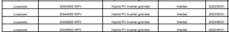

From the City of Cape Town approved inverter list that was last updated on 1 April 2025: https://resource.capetown.gov.za/documentcentre/Documents/Forms%2C%20notices%2C%20tariffs%20and%20lists/Approved%20Photovoltaic%20%28PV%29%20Inverter%20List.pdf

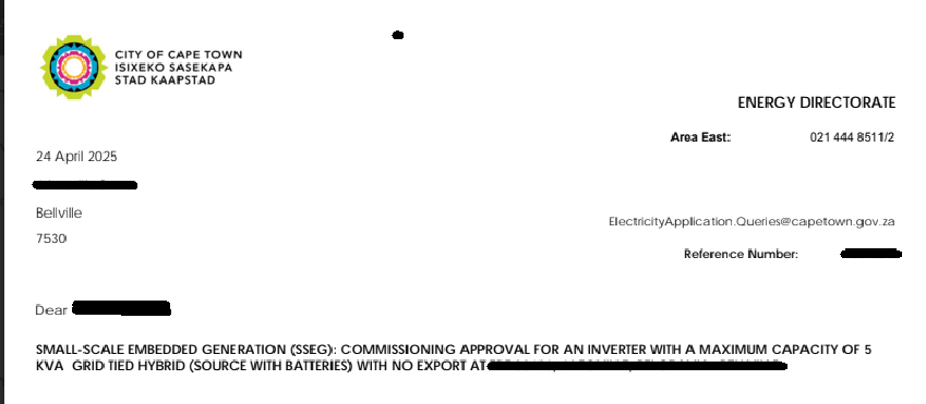

Additionally, I have a SNA5000 installed which was just approved by CoCT
looks like I checked in March which I downloaded and not the updated list. It is good news for some.
I was a bit unsure of the understanding of off-grid but now I understand that it is not a off grid inverter.
Off grid meaning it is seperate from the grid. So certain approved hybrid inverters that are tied to the grid without feedback are approved.
I see it reads grid tied hybrid (source with batteries) with no export.
