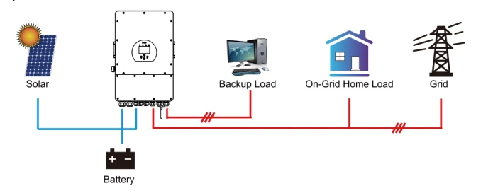

Even when the inverter is connected to the grid there is a limit to the amount of power that can flow through the inverter i.e. your essential loads - Sunsynk or Backup Loads-Deye
The max pass thru current on a 5kw Deye/Sunsynk is limited to 35A (this is at 230V, not 50V) so a max power of 35A * 230V = 8050W
So even if your 5kw if grid connected, if you pull more than 8kw of power on the essential load side it will also trip the inverter out.
For this reason it is often better to have your heavy loads on the Sunsynk - non-essential, Deye On-Grid Loads side as that power does not pass thru the inverter but can still be powered by the inverter.
It is however important to understand that the On-Grid Loads cannot be powered if their is no grid present i.e. loadshedding.
