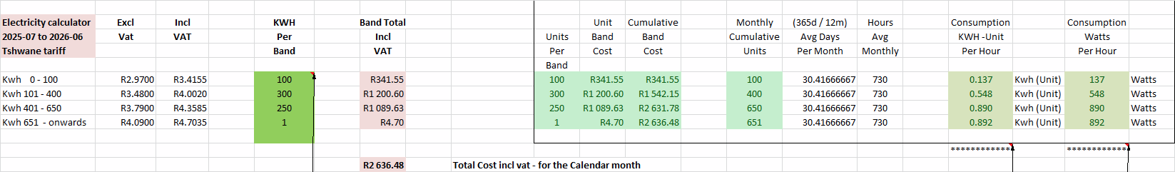

Tshwane 2025-07 to 2026-06 prepaid, single phase, 60amp, for comparison?
The tables from the middle to right, were to get a understanding of average hourly consumption, based on units purchased per month.
For example if you only buy 100 units a month, your hourly avg consumption would be 137 watts per hour, maybe enough to operate one or two residential, energy efficient fridges?

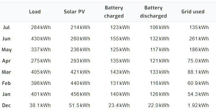

Lat couple of months, I've hurt quite a bit with drawing from the grid to heat the geyser:

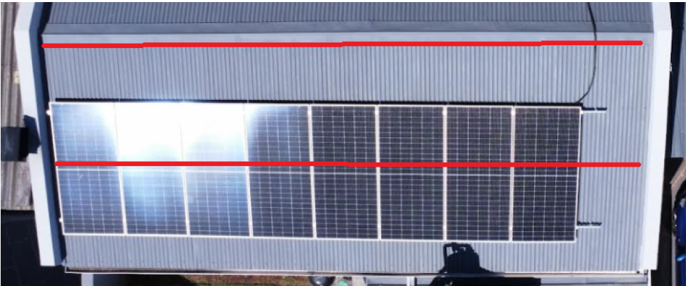

PV production has dropped massively, mainly due to shading. I've added another battery as well which now runs the house through the night after a sunny day, but I should really add 2 more panels so that I have 5 panels per string to get that voltage past the inverter minimum sooner rather than later.

3 minutes ago, Denns said:
A trick I learned from the US guys living in cabins offgrid. Make use of charge controllers. Add a charge controller that is connected to an array that is mounted in an area that gets decent sun.
Also consider a PWM controller if you don’t have a decent area with clear sun the whole day. The advantage is parallel panel connections. Panels in series get heavily affected by shading as your MPPT output is determine by the lowest outputting panel which is the shaded one. PWMs can take Parallel connected panels so even if one is shaded, it doesn’t affect the power from the others.
They are close to enough to as efficient as MPPT if the panel is matched to your system. For 48V for example you can get Jinko 445W panels with a Vmp of 31V or 33V. 2 in series and have 4 of those in parallel. The PWM controller won’t lose much efficiency since the voltage is at 62/66V.
They are a bit tricky to find for 48V but they are available. Can add about 2.8kw of panels onto it and help you a lot with generation.
My budget solution to solve this, is to shift the entire string up. My geyser is whats casting the shadow, so shifting the string up should solve my problem. My intention is then to add 2 more panels below, landscape, and shift them all the way over to the left.
