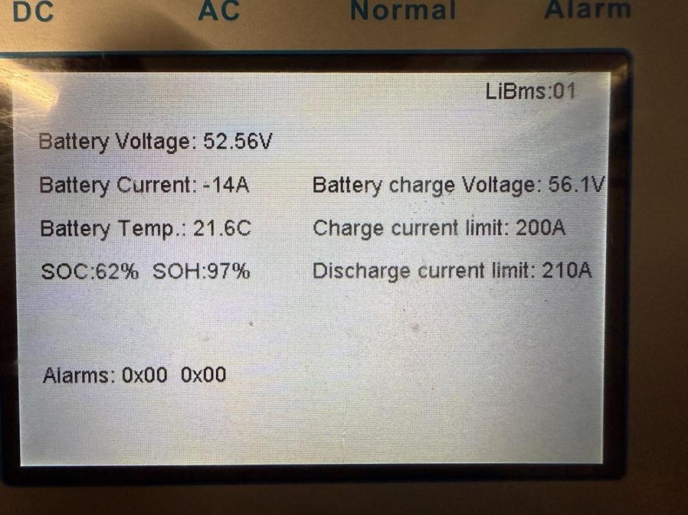

July 24, 2025Jul 24 Off topic, but I am also looking at the same batteries When 2 connected to a 8 kW Sunsynk inverter, I see that the automatic Inverter BMS data shows Charge current limit 100 ADischarge current limit 100ADoes it allow you to change your discharge limit to make use of the full 8 kW of the inverter?These batteries are rated 0.5 CBut Data Sheet says max charge and discharge 100 A per battery and peak (2 minutes) 150 A Just wanting to know anyone with experience with Sunsynk batteries I normally use Hubble AM 5 or PylonsWarranty is the same on the Hubble with unlimited cyclesBut Sunsynk batteries change inverter warranty from 5 years with other makes of batteries to ten years if you use Sunsynk batteries
July 24, 2025Jul 24 Author 52 minutes ago, James 1 said:Off topic, but I am also looking at the same batteriesWhen 2 connected to a 8 kW Sunsynk inverter, I see that the automatic Inverter BMS data showsCharge current limit 100 ADischarge current limit 100ADoes it allow you to change your discharge limit to make use of the full 8 kW of the inverter?These batteries are rated 0.5 CBut Data Sheet says max charge and discharge 100 A per battery and peak (2 minutes) 150 AJust wanting to know anyone with experience with Sunsynk batteriesI normally use Hubble AM 5 or PylonsWarranty is the same on the Hubble with unlimited cyclesBut Sunsynk batteries change inverter warranty from 5 years with other makes of batteries to ten years if you use Sunsynk batteriesAFAIK the Sunsynk batteries 5.32 batteries are rated 1C. I am also running an 8KW Sunsynk inverter with 2 x 5.32 KW Sunsynk batteries and the LiBMS menu shows 200A current limit which I think it gets from the battery BMS. 100A per battery
July 24, 2025Jul 24 Definitely 0.5 C recommend So definitely can't be called a true 1CThanks for the reply
July 25, 2025Jul 25 I also recently bought one from Voltex. Mine was manufactured in 2023. I was skeptical about the charge left in the battery once I noted the manufacture date. Voltex salesman told me they sold lots of these with no returns so far. I have another 2 I bought. 1 in Aug and 1 in Nov 2024 from Harolds. This is my 3rd battery then. Powering up the battery the SOC was roughly 48%. I was happy that it still had a decent amount of charge so connected it to my system as a slave. I assumed the other 2 bought from Harolds will be newer so one of them should be master. I have been running it for a week now and seems ok.......but different. Inverter (Deye 5Kw) Still says 200 amp charge and discharge. I assume it is not picking up the BMS of the 3rd Voltex battery. Is there a way I can check and verify manufacturing date of the other 2 Harolds batteries? (They were bought 3 months apart) I just want to make sure they are the newer ones and that I don't have it the other way around.The Voltex battery is showing lower or higher SOC than the other 2. I charge it to 100% so the SOC should be calibrated. I assume there are no comms to that battery and that led me to this forum.(Hi Im new here 1st post!)
