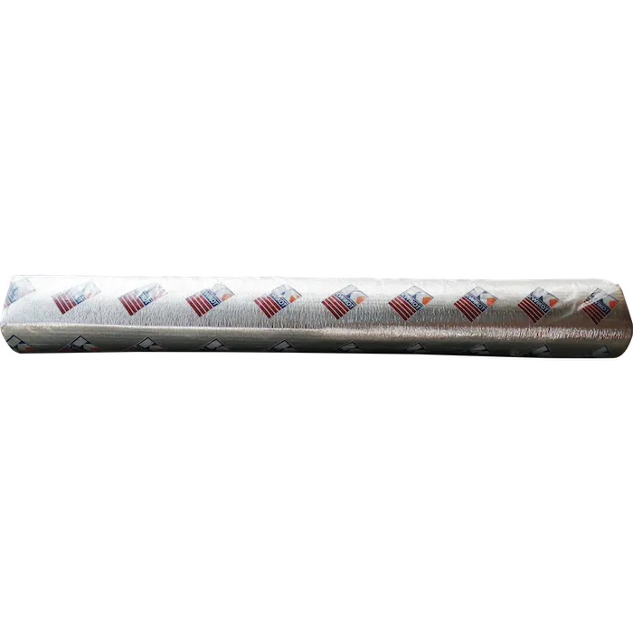

Is a geyser blanket worth it
Wanted to get some of you clever peoples opinions. Is a geyser blanket worth its cost and if so what is the rough payback period on say a 150l Kwikot geyser, I have changed the element to a 2Kw. I have 2 150l geysers in the house, the one feeds the kitchen +_ 15m from the geyser, this also feeds my sons bathroom, this still has a 3kw element. The other 150l geyser feeds the main bathroom (shower only). All geysers are controlled via an Astute smart switches in the DB board. I do have solar (5kw SunSynk, 14.3Kwh of battery, soon to be 28.6Kwh), wanted to try and save as much power in order to charge my 2 batteries. So if a blanket would help the loses it might be something I would do.

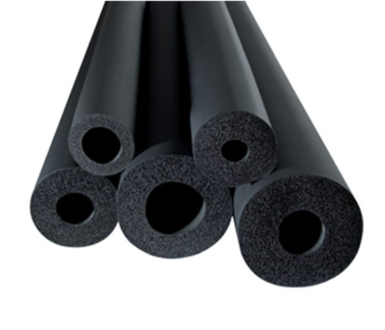

I don't think that timers save you money, but you can control when it heats so mine only heats when the sun comes up so probably costs the same but my solar is heating most of it. Is this the type of "lagging" you guys are using on your pipes?

Heater blankets for geysers may be efficient if you have one that's mounted on an outside wall. I am not convinced it makes much of a difference inside the roof .
Pipe insulation on the other hand will make a bigger difference as the pipes themselves will heat up quicker whilst eliminating radiative losses to the surrounding cooler air.
My take on geysers is that the thicker the polyurethane in the geyser the better, 60mm, preferred or more, but have not found geysers with more. And then pipe lagging, on all the pipes, cold inlet, hot outlet (for at least 2-4 meters, maybe even better, if it can be almost to the tap and overflow/TP valve and pipe to reduce losses. One problem I have with lagging to the tap is the pipes are not lagged in the walls and hot water pipe loses a large amount of heat to the walls in winter. (

Yes a geyser blanket can be worth the cost on your 150 L geyser(s), but how much you’ll save and how quickly you recoup the cost depends on a few key factors about your usage patterns, insulation quality and your system’s electricity costs.
A geyser blanket adds extra insulation around the hot water cylinder, reducing how much heat your water loses to the surrounding environment. Less heat loss means, less frequent reheating cycles, lower energy consumption to keep water at temperature and less draw from grid or batteries. On a 150 L geyser without good insulation, typical daily standing losses are about 1.5–2.5 kWh/day. With a good blanket installed, those losses might drop by ~30–50% (0.5–1 kWh/day saved).
So, potential daily savings 0.5 kWh to 1 kWh per geyser per day. That’s about 15–30 kWh per month per geyser just from reduced heat loss. Also insulate the pipes hot and cold around the geyser especially the first few meters to cut heat loss.
