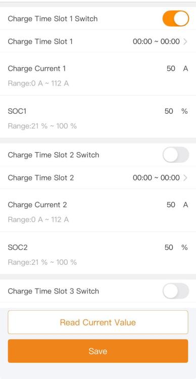

Have you checked the maximum charge and discharge setting under the battery/system settings. Not sure what sections Solis if se for these settings?

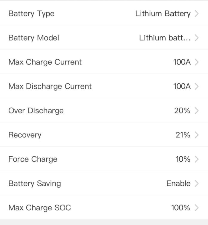

Battery Settings (note I have set max discharge to 100A as per the Sunynk spec):

On 2026/04/03 at 10:01 PM, Pho3niX90 said:
On the soliscloud app, under device -> battery, see what the amps are registered here.
Is grid charging turned on or off? If off, do you have enough solar to support your house load then charge?
Battery Settings Maximum Discharge is set to 100A, but the battery reports 0A. See above.

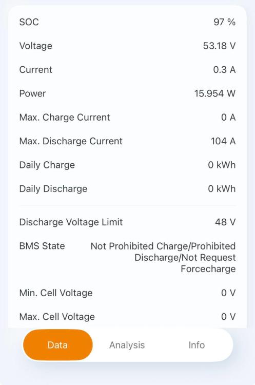

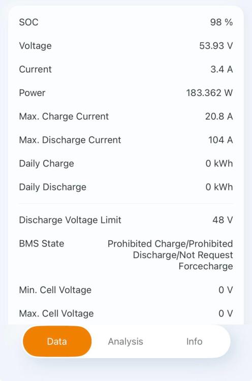

This is what it charged at recently:
Honestly the soliscloud is rather slow. You might be catching it whilst it goes into safety. A direct protocol/modbus test would be the best for this. Or by logging into the BMS's RS485 (unsure what BMS they actually use)

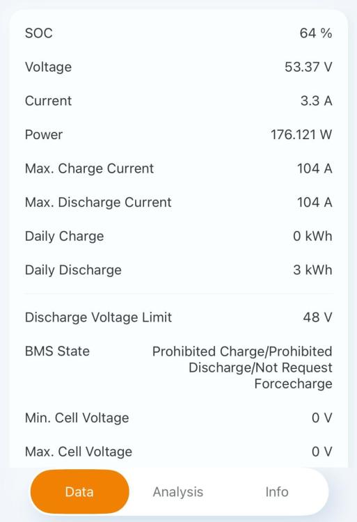

It's mostly normal to charge 180w at the top end of the %, this avoids accidental overcharging.
Next, cut the grid, drain the battery to 50%, then charge it back up again. See if that helps.
You just need to make sure you haven't accidentally set the grid to max 180w as well.
Edited by Pho3niX90
Check my photo from three hours ago, 64% SOC and charging at 180W.

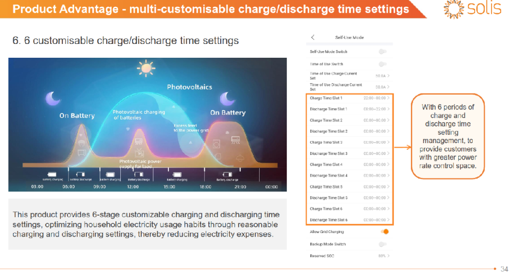

I'm not familiar with the Solis (app or setup), so I quickly downloaded an installation video and a user manual. I always thought that the Sunsynk system settings were frustratingly complex, but I now see that the Solis is at least as complicated, with some really vaguely worded instructions - perhaps it's just the Chinese/English translations... So please keep in mind that the following might be incorrect... Anyway, let's dig a bit deeper:
Have you set the "Quick Settings" and "Self Use Mode" settings for your battery? I could not find any reference to either Sunsynk batteries or Eenovance batteries, so what type of battery did you select in the Quick Settings? (this could be crucial, if the wrong battery/BMS is selected there could be a communication breakdown between the inverter and the battery)If a "non BMS Lithium mode was selected, this could also affect the charging if all the other parameters (Volts, etc) are not set correctly.
In the "Self Use Mode", have you enabled the "Allow Grid Charging" selection? Also, have you entered the "Charge Time Slot" times and "Grid Charging Power" value, and did the times when you expected the batteries to be charged rapidly coincide with a selected time slot?
It might be worth your while to study the manual and setup videos in depth, and to understand all the parameter settings.
Here's an example from the manual - if your actual "battery charge" time coincided with a pre-programmed "battery discharge" time, if probably won't charge much...:
I don't have solar panels but I found this option: Inverter/Inverter Control/Storage Mode/Charge&Discharge Slot and I enabled Slot 1. Let's see if this makes a difference. If this it then it's a pretty well hidden option!
