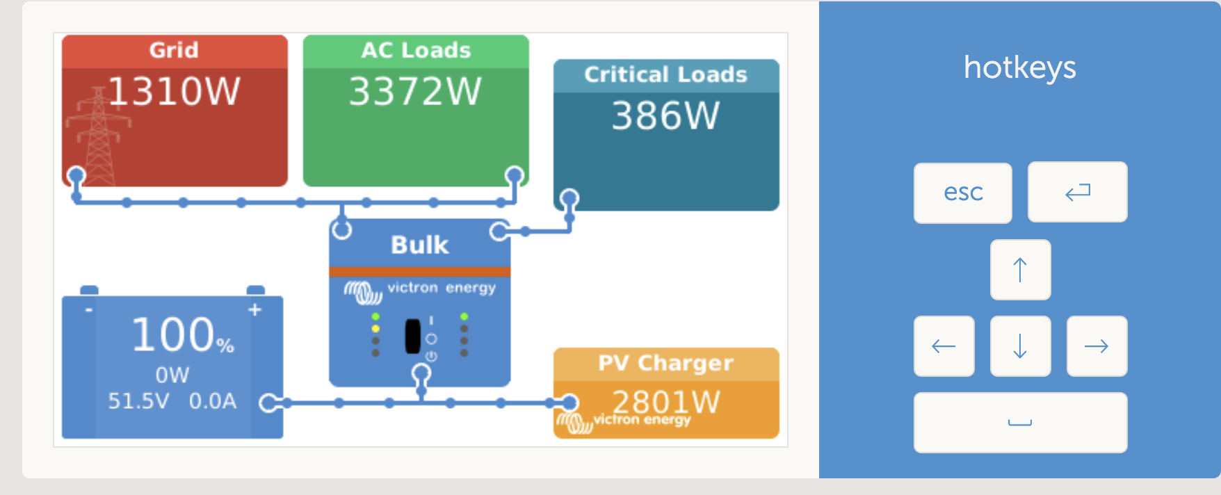

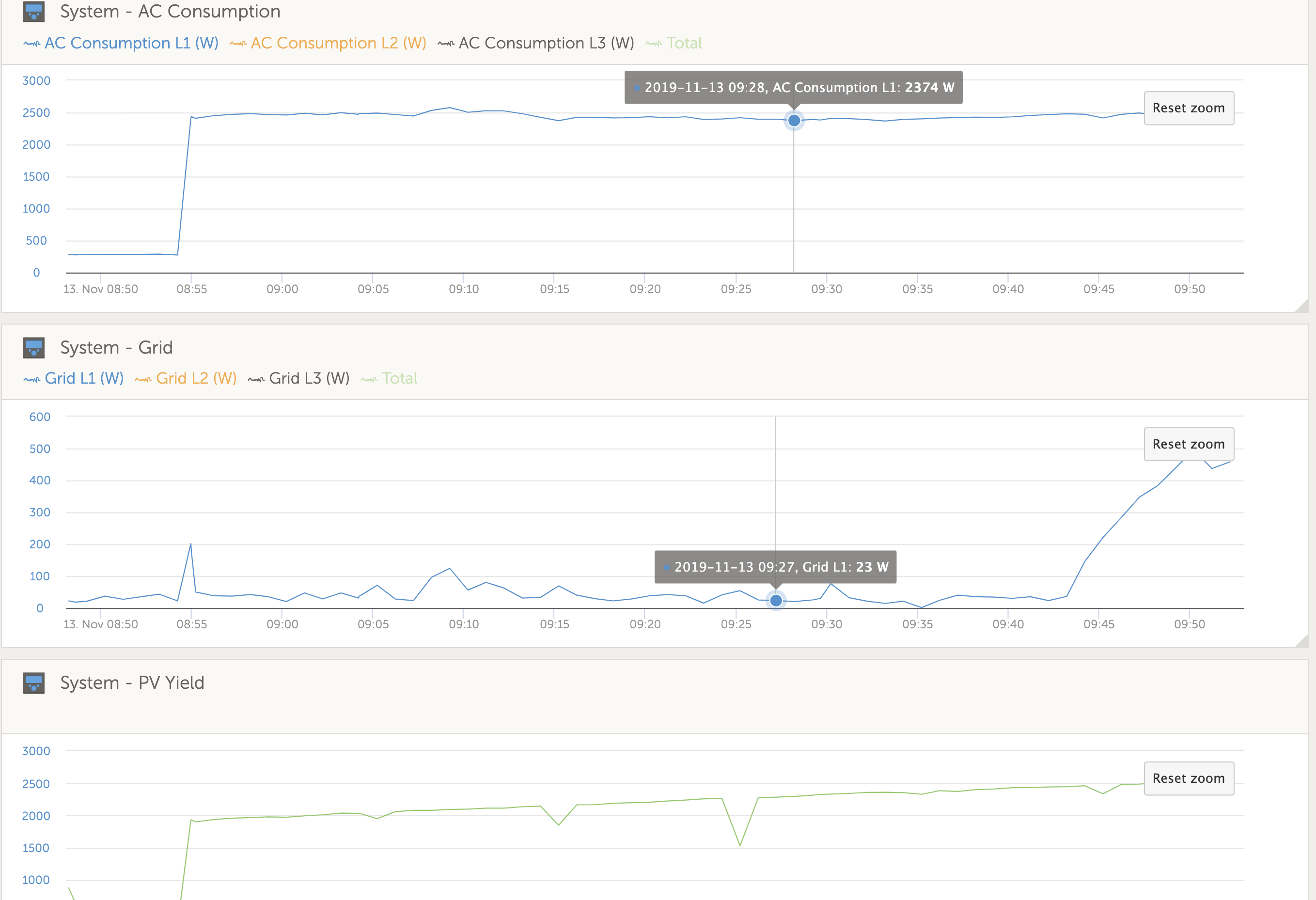

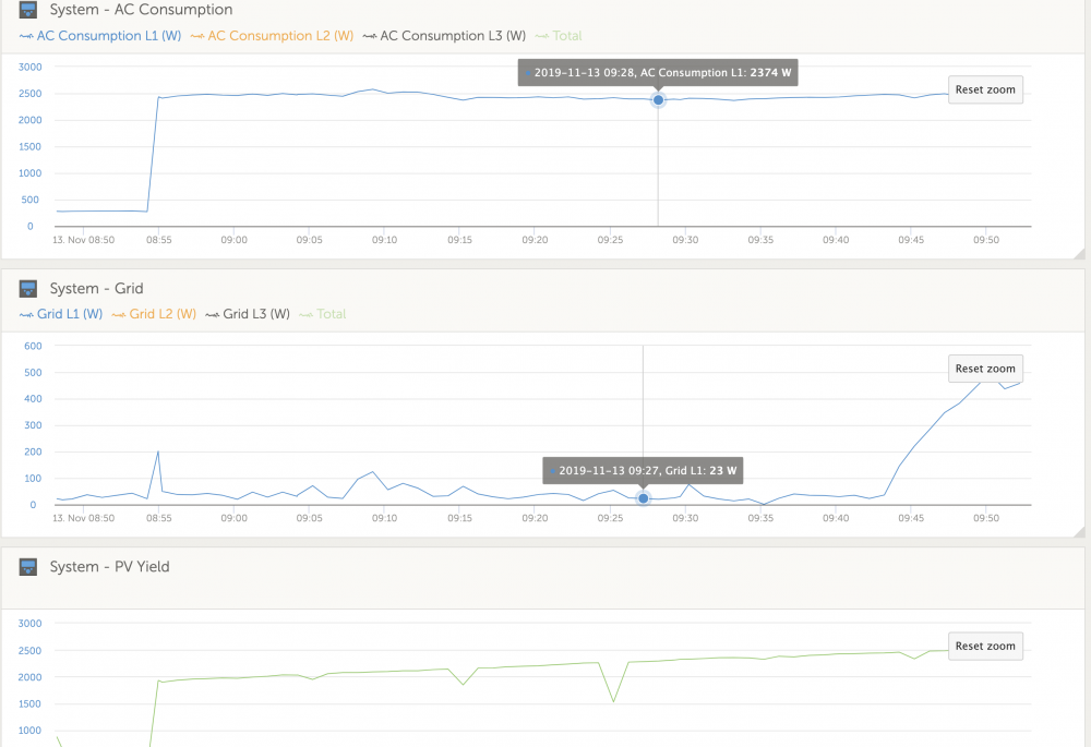

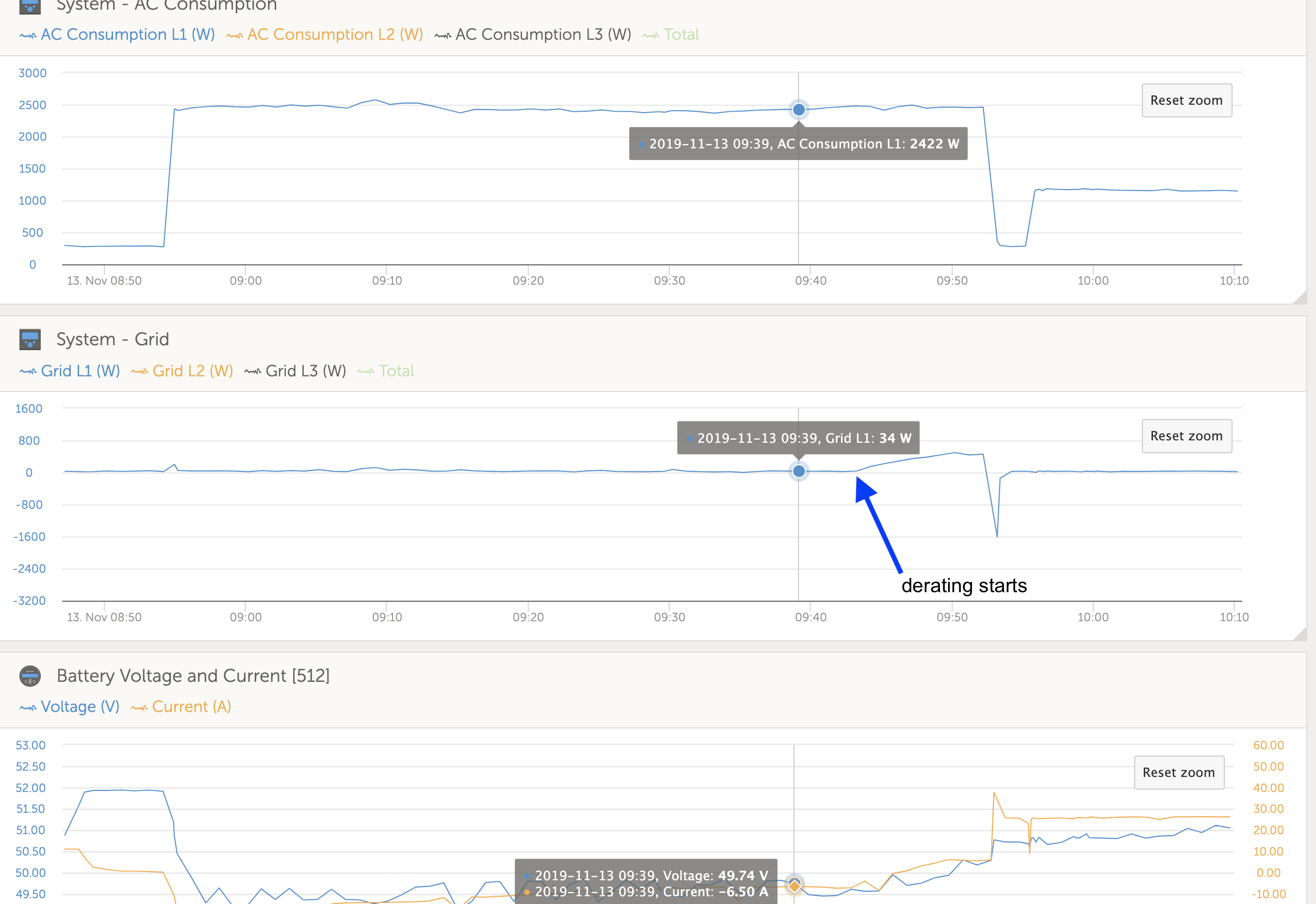

My 3.5kVa Multiplus II derates itself by 400W without fail after 45 - 50 minutes when inverting its max of 2400W. See the graph attached from this morning. Ambient temperature in the garage this morning cant be more than 23 degrees. I've seen the same thing happen in ambient temperature of less than 20 degrees. Is it normal to derate so soon in a mild ambient temperature?
1 minute ago, plonkster said:
See here for information about derating: https://www.victronenergy.com/upload/documents/Output-rating-operating-temperature-and-efficiency.pdf
The Multi does derate further, but what you're reporting does not sound normal. Are you sure it is the Multi and not something else, such as a managed battery?

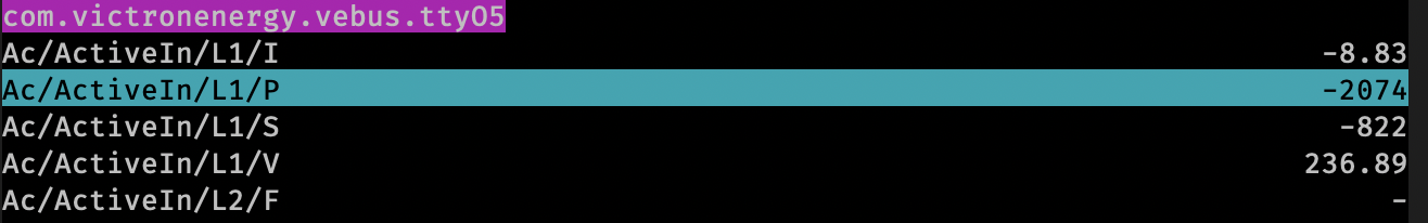

How familiar are you with hacking into your GX device ? 🙂
If you root the GX device (see here), and you log into it using ssh (Windows people use PuTTY), and you run dbus-spy (that's a bit like regedit on a windows machine... don't touch things you don't know), and you navigate to com.victronenergy.vebus.whatever and scroll down to /Hub4/L1/AcPowerSetpoint, you can see the power level that is commanded by the GX device (how much it should feed into the INPUT). On /Ac/ActiveIn/L1/P you can see the actual power being fed in. Compare the two.
The idea is to see if the Multi is being commanded to feed in less, or whether it is slowing down on its own.

7 minutes ago, deapsquatter said:
How do I read this?
If I assume you forgot the negative sign on the AcPowerSetpoint, then the GX device is commanding the Multi to feed 2900W into the grid on the AC input of the Multi. The Multi is however only doing 2000W. The negative sign means the power is exported.
So the Multi is doing less than commanded. So it does indeed appear to be derating then.
Yes that should be - 2937.

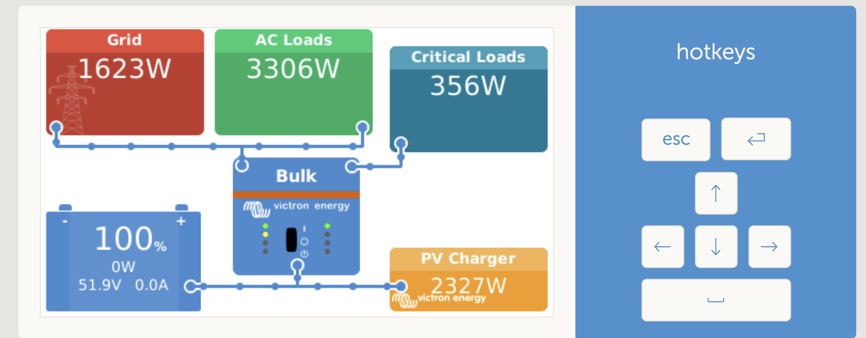

If it's derating how come the animation adds up? (in my mind I wouldn't actually have defined this as derating yet). (3372 + 386) - 2400 = 1358 which is what its saying.
This is a 3.5 kVA multi.
Edited by deapsquatter
Because it calculates the "AC loads" box by using the grid meter's reading and subtracting what's on AC-out. It must add up 🙂
1 minute ago, deapsquatter said:
Apologies I have the 3000VA multi...
That makes more sense. 1657/3000 ~= 60% (a little less), and I know the Multi derates to 60% when it gets really hot. But I have never seen a Multi get that hot. Send me your VRM site link so I can take a look.
