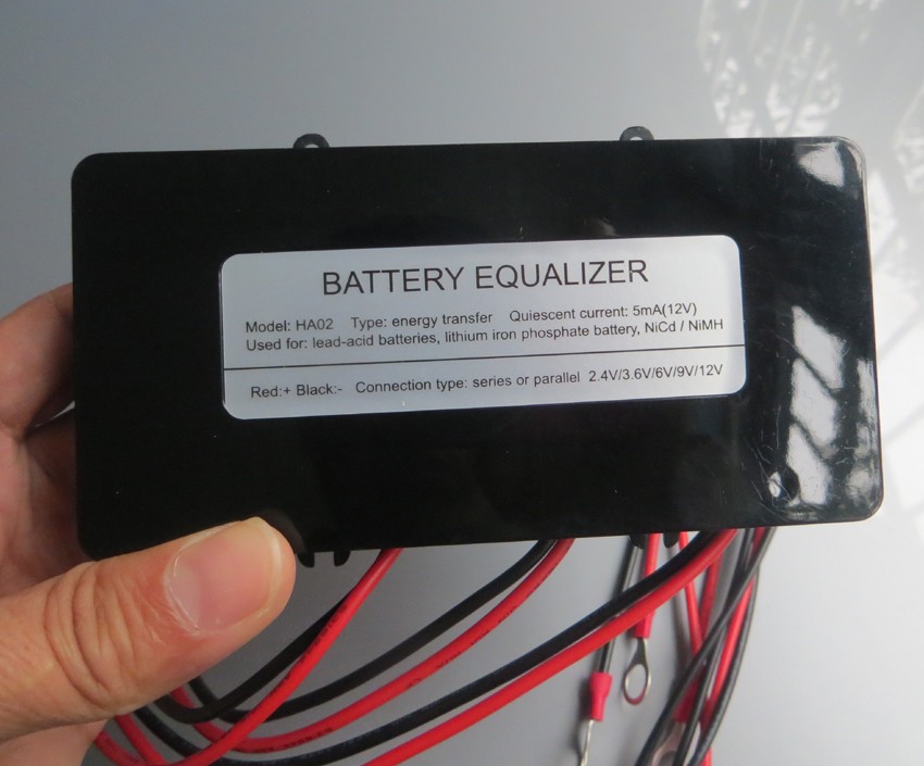

battery balancers
Chris , where did you get your balancers? I also want to buy some
I ordered them on e-Bay. I think Edmund and Mark got their HA02 balancers on Alibaba. Ed may still have an extra HA02. If you buy a HA01 then you need 3 for a 12V X 4 48V system if you buy the HA 02 then you only need 1 unit for a 48V battery bank. For a 24V battery bank you only need one HA 01. Considerably cheaper than the only equivalent I know of (Victron battery balancer).
HA02 http://www.ebay.com/itm/Battery-equalizer-balancer-for-48v-lead-acid-LiFePO4-balanced-charging-/252370442152?hash=item3ac27357a8 (good price I think)
HA01http://www.ebay.com/itm/Batterie-Balancer-Ladungsausgleicher-fur-24V-48V-Batteriesysteme-Solarakku-etc-/131473322599?hash=item1e9c6bb267 (expensive in my opinion - unfortunately my seller no longer stock the item)
The HA02 above is a good price since it is the equivalent of 3 X  HA01s or 3 Victron battery balancers. The only thing I do not like about the HA 02 is you have no indication whether it is active or passive at any one time. The HA01 has little LEDs that flash. A BMV 702 mid point reading is helpful though in the absence of LEDs. I think Mark's mid-point reading dropped from a max of over 3% to below 0.7% immediately. My batteries took about 2 months to come into balance. Having chatted to Dockarl from Australia I was expecting it to take a while with my big 260 Ah batteries but was not expecting from Sep to Nov. My batteries now never go over 0.7%.
