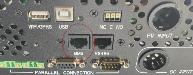

Confirmed spf5000tl-hmv-p HELP HELP HELP
Has anyone actually managed to get the Growatt spf5000tl-hmv-p 2 x 5KWH in parallel working with the Pylontech UP5000 batteries (battery FW is on version 2.8?) I've tried everything mentioned on the forum.If I select LI02 it just shows that the batteries are at 100% even though they are not at 100% and it doesn't switch over to Eskom. If I select LI04 it just beeps and flips between error 04 and error 20 and eventually switches off because it can't read the batteries. I know for a fact that the batteries are at about 40% but it only shows 100% and then it will display a 04 error and then flip to 20 then back to 04 then back to 20.
Any tips or any ideas? Also tried different cat 5 cables with and without GND. I've tried the dip switches on 1000 and 0001
The inverter only has the ports as per the pictures below. So no can port.
I don's how some people have managed to get theirs to work.

On 2023/06/02 at 12:43 PM, McAllstar said:
I only have 2 ports, one port labelled BMS and one port labelled RS485 nothing called CAN port.
The port labeled BMS is the CAN port

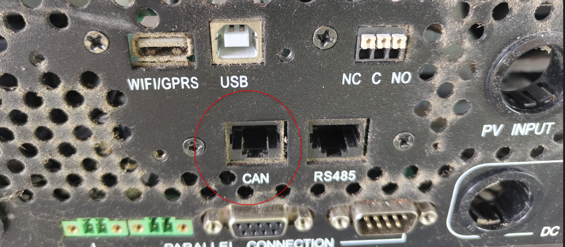

 Hello,
I'm exactly in the same configuration than this user :
I bought my first Growatt inverter on 05/2021.
My actual configuration with the first Inverter is :
  • 1 x Inverter Growatt 5kW 48V - MPPT 100A - SPF5000-ES
  • 10 x Solar PV 400W Mono - Vertex S - TrinaSolar
  • 4 x battery Lithium 2.4kWh - US2000C - Pylontech 48V - 50Ha
The system work and battery communicate with the inverter using CAN/RJ45. My battery program selected in the inverter is : Li program 05-36-L52. All Pylontech battery have DIP Switch in 0000.
Since a frog was entering into the inverter last year, I decided to buy a new one as a spare this year and i recently received the package.

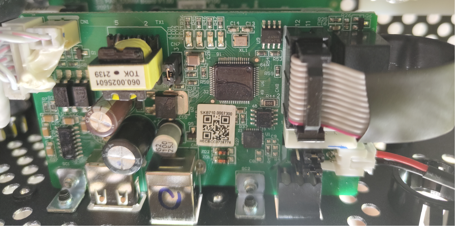

I saw that there is a little difference between both inverters located on the communication board.
OLD Inverter :
New Inverter :
Board communication are differents.
My problem is when i'm changing the inverter, the new one won't communicate to the battery and indicates ERROR 20 / 4 alternatively and finishes to shutdown.
I have exactly the same configuration and wiring, and I'm configuring the Inverter with the same Battery parameters (Li program 05-36-L52).
but for an unknown reason, the inverter won't communicate to the battery and I was obliged to switch on the old inverter.
I rolled back to my first inverter due to the BMS communication problem.
The both are the same inverter model (Growatt SPF 5000 ES).
The only difference is that the new one has a different communication board.
Test L51, L53 .... nothing change.
I'm using the same wire and RJ45 cable (just unplug and replug to the new one).
Could you please help me to solve this problem if any of you have already been in the same situation.
Best regards to all
Apparently your new inverter does not have a CAN port, so you cannot use the same Li 52 settings but rather Li 02 or 04 with the rs485 port of the Master battery with the dip = 1000.
The problem if i not mistaken is that RS485 require a specific cable which is not supply with.
Have you been getting experience with RS485 using RJ45 CAN cable ?
I saw someware that CAN/BMS input is same.
Hello,
indeed it would take a different cable that you can make or get help from a computer specialist, it is a crossover cable that you will need. just two pins are used: pin 1.2 on the inverter side and 7.8 on the battery side but crossed, i.e. pin1->pin8 and pin2->pin7.
Best regards
17 minutes ago, Bafaro69 said:
Hello,
Best regards
Yes exactly what i've seen in the documentation. but about the protocol in the inverter. L01, L02 ... which one is the correct ? is there any documentation about these +50 battery protocal listing ?
Bad news, no communication between the both...
I created a custom cable by cutting an another RJ45 cable and mapping pin1->pin8 and pin2->pin7.
I tested the cable using a multimeter. I'm 100% sure the it work !
Then,
1) shutdown the battery and update DIP switch of primary to (0001).
2) connected the inverter to the battery using the BMS (INVERTER) / B-RS485 (BATTERY) port with my fresh custom cable.
3) Start the battery and then inverter and update the Program 5 in config
I also test configuration L01, L02, L03, L04.... none of them work.
At this stage, i'm sure the custom cable work.
I'm sure that my battery communicate correctly (i roll back to the older inverter SPF).
My hypotheses are :
- Maybe the inverter com board is broken. but the inverter is freshly unpackaged. Never used.
- The configuration of the program 5 have change between the old and the news SPF-5000-ES
What could you think about it ?

I have a doupt with order of pin 7 & 8 with my cable.
I will make another test.
The dip switch must be 1000 and Li must be 02 for 04. Also you must use the BMS port of the inverter and make sure that the rj45 with pin1,2 is on the inverter side.
Awesome, Fantastic my friend !!!!
Good job ! You are the best !
My problem was the wiring pins schematic of the RJ45 in the SPF 5000 ES manual... Growatt reversed the pin numbers .... but I checked on this thread and I saw the correct wiring.
Definitely lack of serious of growatt service .... In the documentation, nothing is clear !
You just want to replace it ? you can't !
You have to build another cable, change communication port, change battery DIM, change inverter config !!!
Same inverter model, same ref ! It's catastrophic !
So, for thoses who are in the same configuration as me please follow this method.

1) find the inverter version depending on the COM board version.
The Old version doesn't have 3 leds.
2) The old inverter version, plug directly the standard RJ45 cable from battery (A/CAN) to the inverter (CAN).
Keep all battery DIM switchs set to 0000.
Select in inverter configuration : 5-LI, then 36-L52
2-bis) if new version COM board, build a new cable using paring 1,2 => 7,8. see previous message in this thread.
then, change DIM switch to 0001.
Plug the new cable for Battery (RS465) into the inverter (BMS) input.
Select in inverter configuration : 5-LI, then 36-L04 or L02.
