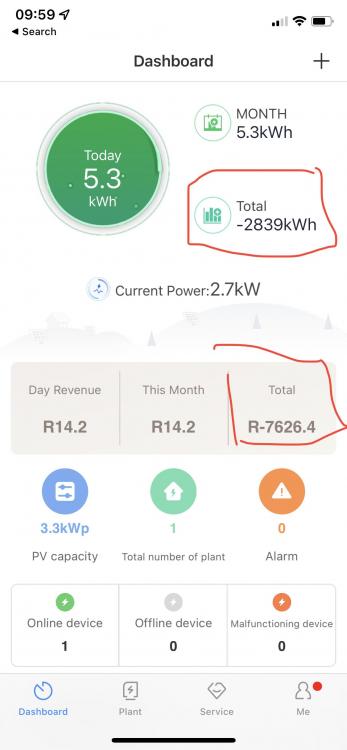

The only issue I have is the total values from the comm card is in minus values. Other than that I’m happy with the update. I scheduled a meeting with Amos to has a look at the issue. At this time I’m leaning towards a DB or software bug.
