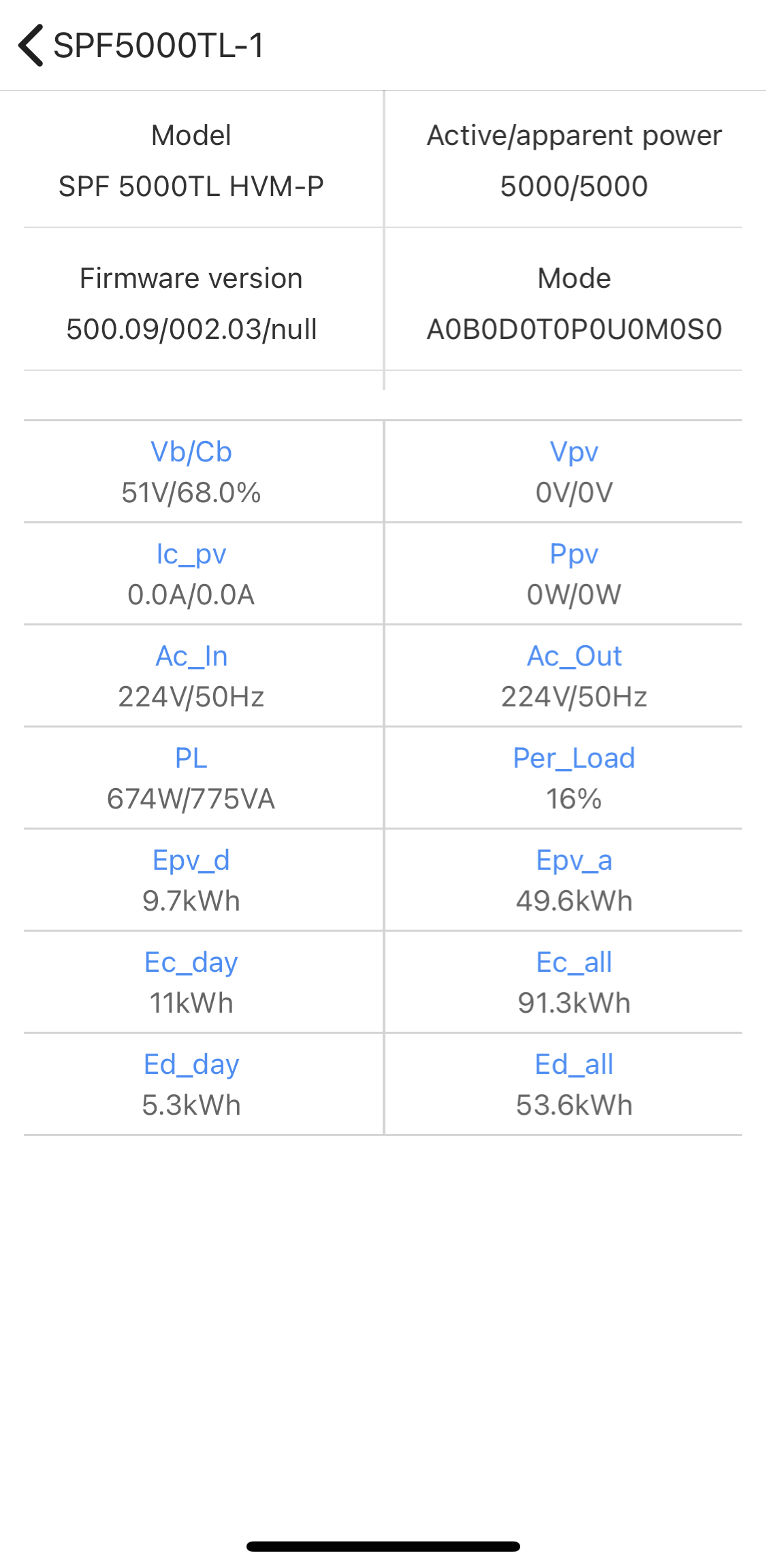

On 25/11/2020 at 17:52, Iss said:
Je suis actuellement exécuté 500.09 / 002.03. J'ai dû exécuter 3 mises à jour pour le faire fonctionner. Un pour l'onduleur, puis BMS et le dernier pour la carte de communication sur l'onduleur.
Hello my Dear ISS, I also have similar problems with my three SPF5000 growatt in parallel and three groups of pylontech batteries connected, using the LV-HUB from pylontech and the rs485 / CAN HUB from growatt, to gather the communication from the inverters to  the LV -HUB.  my problem is that with my three groups of 18 pylontech batteries, the inverter only displays 8A while I have a power of 14kw of solar panels.  I have to put on USER to be able to charge the batteries.  but with the USER parameters the SOC permanently displays 100%.  I ask for help.  I am in contact with my supplier in china and growatt but no solution on the horizon.  not sure if i need to update the firmware as well, inverters are currently showing version 500.06 / 002/00 / null.  please send me the latest software versions and the necessary explanations.
