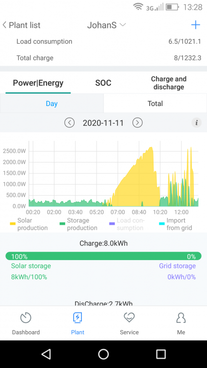

I run two SPF5000TL with 24 PV and 2 x 9.6KW Pylontech stacks.  I use the firmware originally provided by Siliconkid.  It works fine accept the charging form PV doesn't seem to work very well and charge current is limited to 25A (too low for 20KW batteries), the use2 setup works fine for me.   Can you perhaps post your typical charging graph logs, I would like to compare with the BMS controlled results you have.
Image: This is what my charge curve looks like, charges up to 53V until sunset:
Second image: my daily chart on one of the inverters.
