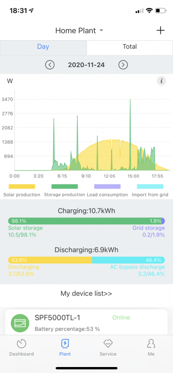

I run two SPF5000TL with 24 PV and 2 x 9.6KW Pylontech stacks.  I use the firmware originally provided by Siliconkid.  It works fine accept the charging form PV doesn't seem to work very well and charge current is limited to 25A (too low for 20KW batteries), the use2 setup works fine for me.   Can you perhaps post your typical charging graph logs, I would like to compare with the BMS controlled results you have.
Image: This is what my charge curve looks like, charges up to 53V until sunset:
Second image: my daily chart on one of the inverters.
My spf5000 charge to 95% then keeps it there till sunset

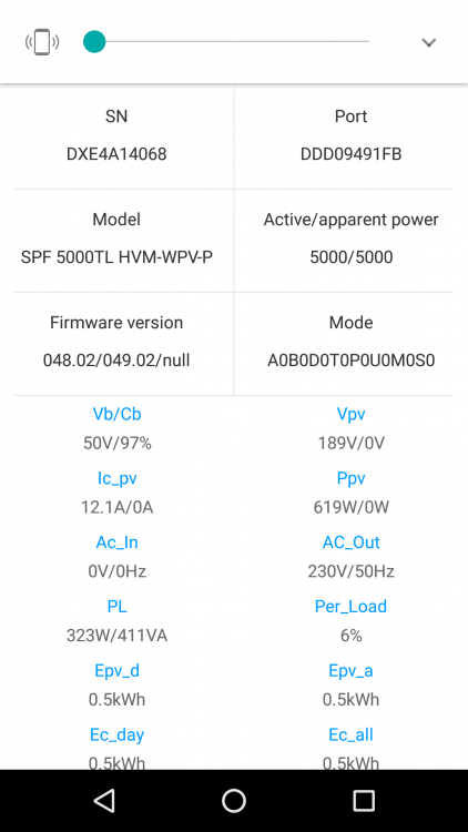

What i notice was that my inverter volt stay the same 50.8 and the charge amps varies from 10-50 amps on shine phone when load increase
Thank you for the feedback,  I have adjusted the float voltage down to 52.2V now, just to be a bit on the safer side, however Pylontech specifies charging voltage up to 53.5V.  Unfortunately with the BMS running things I could not get my 8 x US2000 battery group to charge at 80A . it always limits around 25A, of course bat amps report higher with load requirement above this charging current level.  On USE02  I can get my battery stack fully charged by PV at 80A.  I am yet to see someone with PV panels and BMS reporting a proper high charging current on a large battery group.  Will just have to stay on USe02 mode for now.  Works quite well for now.

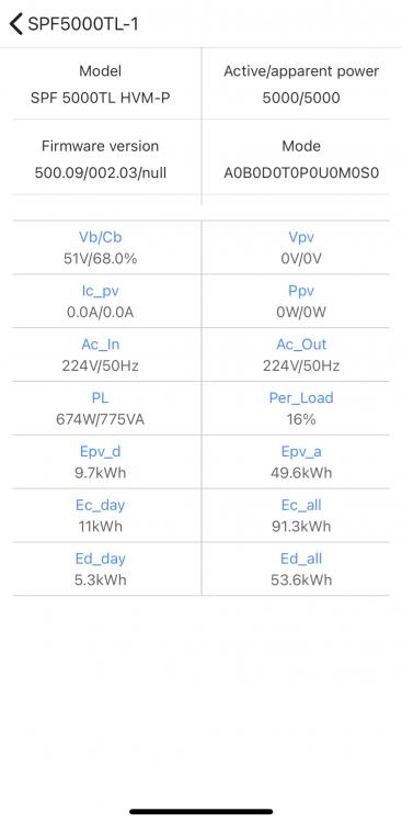

Today has been one of the better days in Jozi. Looks pretty good so far. I’ve also notice that Amps fluctuate to 32.6Amps. It is controlled through BMS. You can’t change the charge percentage. For me it works. One last thing I did do was change my battery wiring to a parallel.

I am currently run 500.09/002.03. I had to run 3 updates to get it working. One for the inverter, than BMS & last for the communication board on the inverter.
