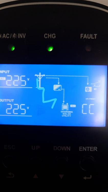

 as you see it on battery backup applications no solar we have a problem .. and the charging symbol is gone never to return .. draining batteries in some cases till they are empty. Just did a test with old 4kw 48v mecer and dont have this issue . So its a problem with the firmware . pending resolve it will mean taking it up with the manufacture and supplier until either a change out for a model that does work or a firmware patch to fix the issue at hand ..
By "charging symbol" do you mean the dotted lines pointing into the battery?
Or the "CC" in the bottom right corner?
Browsing the 500.07 firmware today, I see that the variable I'm calling chargeStage can only have three values, 1, 2, or 3, and in various commands these display as FC, CC, and CV respectively. I assume that these mean Float Charge, Constant Current, and Constant Voltage. So it's surprising to see the firmware apparently not charging at all. I suppose it's possible that this variable has been set to an invalid value somehow; if so, that's definitely a firmware bug.
Of course, there may be other variables that determine charge stage, I don't pretend to understand even 1% of the Growatt firmware as yet.

So to highlight the three stages correctly this is actually what takes place .
CC
Then CV
then FC
if the systems remains in FC for too long the AC to DC charger symbol disappears and if you pull the plug and renable the power it enables the charg e process again .. and after the 2 or three hr window the symbol showing battery charge goes off the screen meaning no charge being applied at all to the battery . This is clearly a Firmware float bug issue . i Know i did question and send you a Pm about the issue regarding the Mecer/Axpert but it doesnt exist .. its true to the settings and holds its float well .
So this is  a Growatt issue . The higher model 5000es 450v MPPT doesnt do this. It holds and maintains float respectively .

sorry not that is is not charging at all
on use setting we get the CC and CV stages and even the FC stage.. meaning we bulk absorb and float .. but float only remains on for about between 2 and 4 hrs which is not great .. why should it turn off ?
