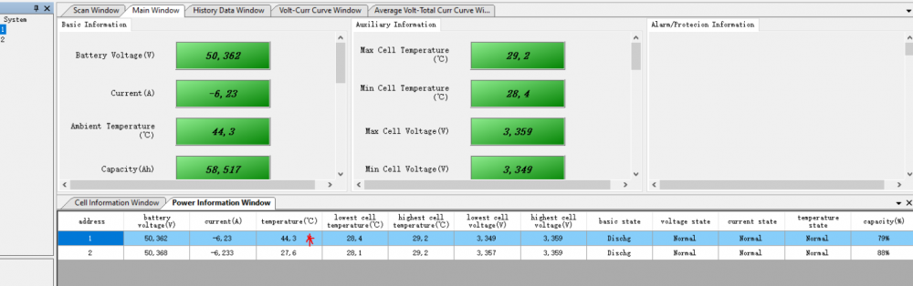

So looks like it's a faulty BMS on the battery, I'll be sending it back.
Had to manually crimp a RS232 cable to connect to console on the battery. And I found the 1 battery only gets to around 90% charged before it appears to do nothing while the other one charges. Another thing I spotted was the temperature increases much higher than the other battery while charging.
