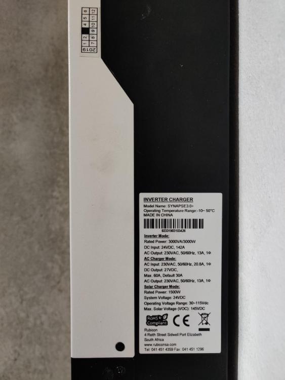

Slightly off topic, but I would like to ask you about your Synapse 3.0+ 24V inverter, as the residential complex I live in on the KZN South Coast has a few of these units installed, together with many CBSolar 24V inverters and a handful of Mecers
The CBSolar inverters have been the standard for 2 years and apart from a few failures have performed well. We are still getting to know the Synapse and Mecer.
One issue we have noted with the Synapse 3.0+ is that the fan runs continuously, this is not the case with the CBSolar and Mecer.
Do you know if the Synapse is a Voltronics, or a clone?  Who supplied the unit to you?

Good question, I believe the Synapse isn't a clone - perhaps someone more knowledable than my can confirm?
I've had a read through another forum thread which shows you how to identify if it is a clone, I've done most of them apart from hooking up that dreadful WatchPower app. I've included a picture of the side labels below.
The fans do run a lot. I think the only time it isn't running is when the batteries are in float and PV isn't being used. I had my panels installed mid-month last month and have noticed that the fans run a lot. It doesn't really bother me since the setup is in a room outside of the main house.
The Synapse has been running as a loadshedding backup solution with batteries connected since December, I haven't had any issues... apart from posting here and wanting to upgrade to Victron gear ;)
