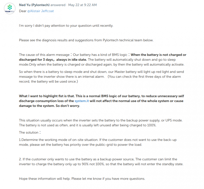

August 14, 20206 yr 19 minutes ago, Cassie said: I now have 2 Pylontech US3000 batteries on 2x Axpert inverters in parallel with a Raspberry Pi and CCT monitoring program. They performing very well without any problems since I installed the first one in the beginning of June and the second one end of July. This past weekend the red "ALM" led light on the master battery appeared. I rebooted the whole system and the "ALM" red led was gone. Then about 2 days later it was back again - after another reboot it was gone again. At the moment the system just performs as a UPS. No PV panels installed yet. I assume "ALM" represents "an alarm mode". Is this something serious or is it an indication that the battery bank is only in stand by mode? It will happen every 48 or 72 hours (Cant remember ) if you dont discharge your batteries. It does happen in battery backup systems without PV panels and self consumption. The alarm is not serious, but it remains annoying. I found a site a while back explaining what in the firmware causes this, bu cant seem to find it now. EDIT: Wait here it is. its under the Victron Q&A section.

August 15, 20206 yr 26 minutes ago, Cassie said: Is "equalise" charge the same as "Float charge". On the Victron systems we set Absorb to 52.5Volt and Float to 52 volt. I guess in your system, a small difference like this will be sufficient to wake the Pylons up and get them out of "Idle" mode. It seems like this alarm only gets activated in Idle mode, or that is what we saw on battery backup systems.
August 15, 20206 yr Author 3 minutes ago, Jaco de Jongh said: On the Victron systems we set Absorb to 52.5Volt and Float to 52 volt. I guess in your system, a small difference like this will be sufficient to wake the Pylons up and get them out of "Idle" mode. It seems like this alarm only gets activated in Idle mode, or that is what we saw on battery backup systems. Thanks Jaco, It looks like that is what the Pylontech guy (in your previous comment) is also suggesting. Did you see my last night comment on your post of 2018 regarding battery tools?
August 15, 20206 yr Please see this LiFePo charging curve: An equalize, is actually a higher than normal charging voltage used with Lead Acid batteries, that get this moving around on the plates and does a form of top balancing every once in a while. So in your case it would appear to your full battery as if it was getting charged every so often. However, I wouldn't recommend it. As you can see from the graph it takes very little charge to shoot the voltage up so: 1.) It may not fool the BMS 2.) It may result in your battery shutting down, to protect itself. 3). If you want battery longevity, stay away from the high and low voltage kneepoints on that graph. 4.) As you can see there is very little Ah capacity to be gained by working into the kneepoints. I'd rather do Ned Yu's suggestion or just use them a little bit. ( Some load on a timer or something). @Coulomb, is right about the US3000 being master as well, I have read that too. I don't know maybe I am mixing things up.But assuming the same rationale, it would seem that Pylontech would have the highest capacity battery as master. Which generally would be the new one, I don't think that would matter in your case though. Edited August 15, 20206 yr by phil.g00
