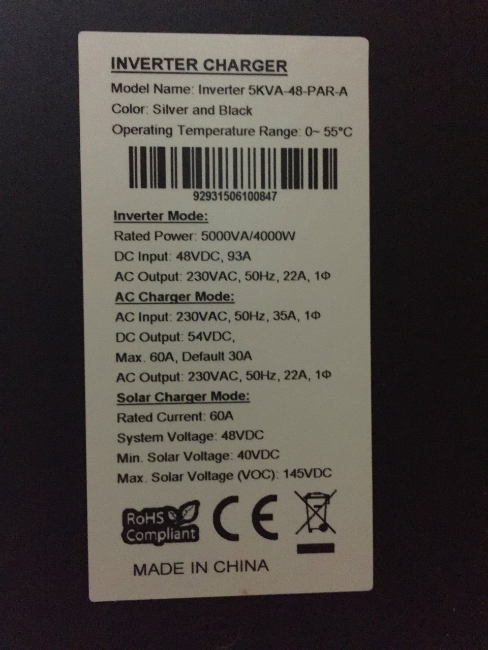

What Brand of the Inverter are you using? What manufacturer is it?
Here is the label of my inverter (parallel slave): No manufacturer name! Strange!!:unsure:
The label above looked familiar ... like the one below, same factory maybe?
Mine is a Mecer.
Excuse the blurry pic but the label faces the corner of the room and the battery bank stands in the same corner so the photo is taken "blind".
From the labels I would guess it is made in the same facility. I was told that a Mercer was a rebranded Axpert. When I queried MPP Solar I got the exact same response. Perhaps they feel that  Mercer should be answering all the queries.
From what I understand it is quite difficult to brick an Axpert. The one proviso is to use a serial cable rather than USB and that you use COM 1. I only have a USB cable so I have taken the "if it ain't broke don't fix" philosophy.

Peter, I have an MPP Solar branded PIP-4048, and it has much the same label, except the model number on the label is "PIP 4048MS". As others have mentioned, it's probably one distributor saying to go to the other distributor that made and sold it to you. All the real Voltronic models are designed in Taiwan and manufactured in China.
Quote
Most in Australia use MPP Solar or Giant Power brands. In South Aftica, the Axpert and Meccer brands seem popular, but I think that there are others. As far as I know, these are all made in the Voltronic factory in China, or made for them by someone else, and are all identical apart from cosmetic things like logos and colours, perhaps slightly different metalwork. Likely the electronics is 100% the same, or at least functionally identical.
As noted elsewhere, the lack of manufacturer name on the label is curious, but all the labels seem to be like that, so it's not a red flag by itself. The only illegal clones (as opposed to officially sanctioned branded models) I know of are branded MUST, and all of these seem to have a stripe at the bottom of the front panel. But of course, these things can and will change quickly as the copiers attempt to dodge law suits and recognition by potential customers.
