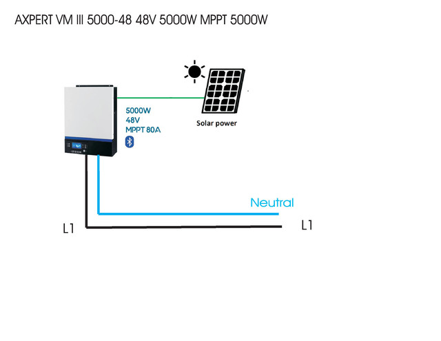

AXPERT VM III 5000-48V + MPPT 5000W
You can start you inverter on PV panels but at least 6 to get a good VOC voltage range.
You can work without batteries but when shadow clouds cover your panels power goes down an inverter well stop feeding your load untill shadow disappears.
