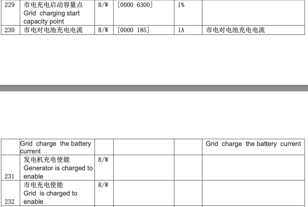

Hey all, I have a system setup with parallel Deye SUN-12K-SG04LP3-AU inverters, and want to be able to 'force charge' from the grid to the battery based on certain events. I've tried setting register 229 'Grid Charging Start capacity point' (from document v118) to a value above the current Battery SoC amount, but it doesn't seem to start charging the battery from the grid, so what do I need to do to get it to force charge from the grid? (Currently, Using Node-Red, networked to a PUSR-N520 wired to pins 1/A+ and 2/B-, sending unsigned16) for the Battery SoC, function code 0x10, and unitID=1 (as matched to the master inverter), but no luck. Are there any other settings that I need to check /verify or write into to force charge the battery?

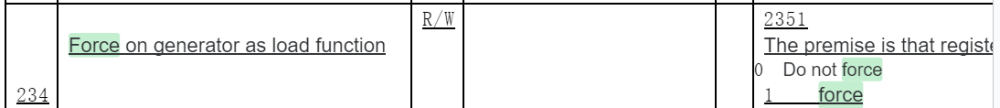

I think that you will need to write a 1 back to Modbus register 234 to change the menu option remotely

It would appear like / feel like I need to set some more registers sequentially after 229, such as these below, but since there's no valid values range and textual description, I'm a little hesitant to do so..

added pic for more context
Is the grid considered to be the generator? (Sorry I'm a little confused by your question - but maybe it was a typo???)

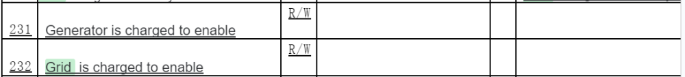

Could be this one
and maybe these ones.
Would read the values, change them manually on the inverter and then read them again and check if the values change
Could be this one
