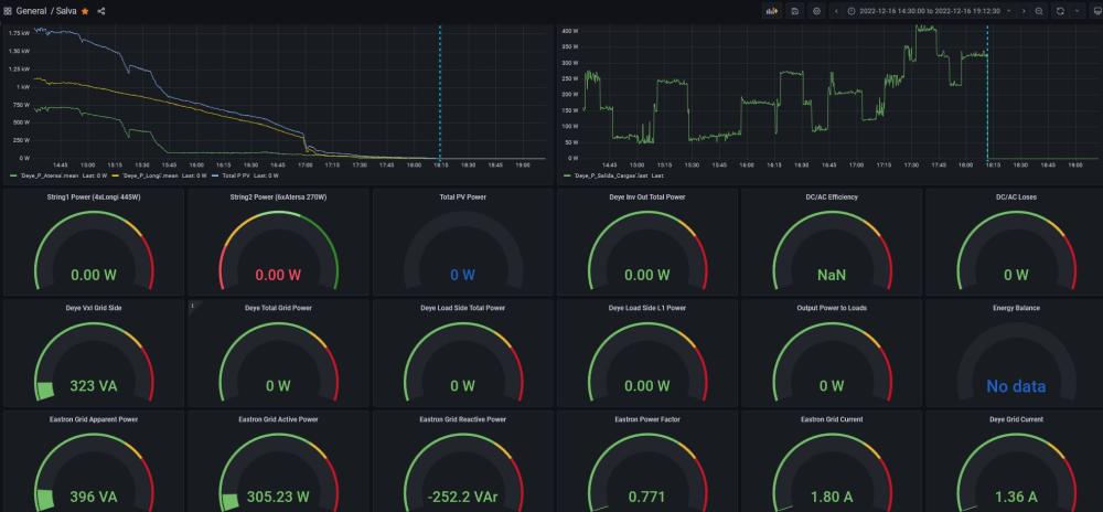

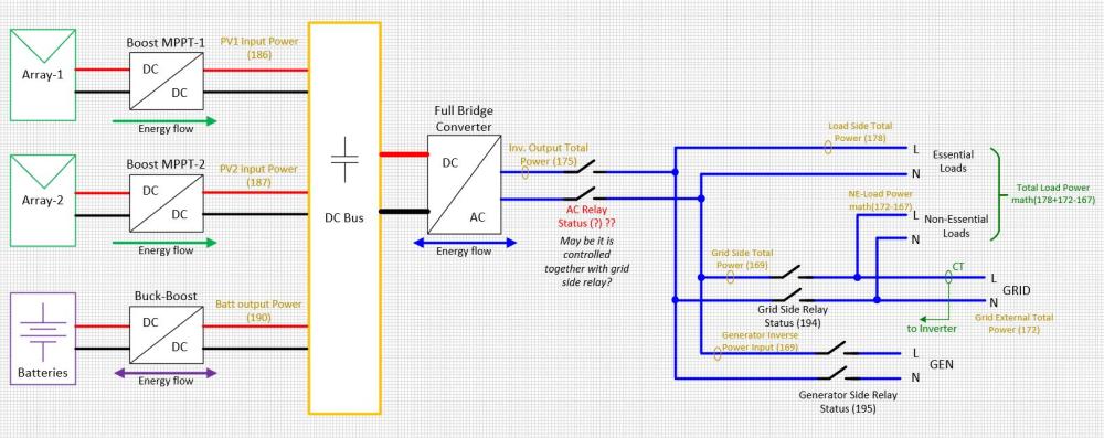

Hi there everybody,
I'm running a Deye sun 5kW hybrid inverter for a month. No batteries yet, but some loads are conected to the Load Output (essential loads).
I'm trying to figure out where the sensors are located over the hardware because some measures obtained via modbus are confusing to me.
I have drawn the following block diagram including the sensors where I think they should be placed. However, measures tell me I must be wrong  (e.g., Inverter output total power and Load side total power always match, even when part of the pv power is been sent to the grid and the rest to the essential loads output).
Furthermore, all power measurements drop to 0W when no PV power is available. The inverter goes OFF (running status goes "stand-by"), I supose this may be because I have no batteries installed yet. Loads remain grid connected, but no power measurements are obtained. The only measures available are Grid voltage and current, so I can compute the grid apparent power but not active (or real) power.
Hope you will help me some how.
Two questions: are you 100% sure exporting to the grid is what you want to do (if not don't worry apparently you havnt done so yet), and is your CT coil correctly installed on the main incomer?
Edited by Scubadude
Hi Scubadude,
No batteries yet, so the system is running as on-grid inverter exporting power excedents to the grid (I do, not a problem at the moment). CT coil is not connected, I could install-it but think my problem is to figur out why the internal measurements (Grid and Load power measurements) are lost when PV Power goes 0W. It is normal because the inverter switches to OFF or could it be related to a config problem? and, are the sensors located as I think?
Thanks a lot for your reply.
Hola sorts! I missed the Valencia bit earlier - of course export is much more feasible in Europe than it is in SA. The inverter cannot see your non-essential loads. So a CT coil is required to measure grid power consumption and selling to grid. Your inverter is not faulty - if it has nothing to do it records zero values.
Edited by Scubadude
Hola Scubadude,
Think you are right, I have installed CT coil and the inverter has measured the External Grid Total Power (172) until the sunset. At the time PV power has droped to 0, the inverter goes to stand-by mode, "nothing to do". It no longer carries out math computations like powers. I have an Eastron metter at the grid input side but I expected the inverter continue measuring grid and load powers at night.
Thanks a lot for your comments.
