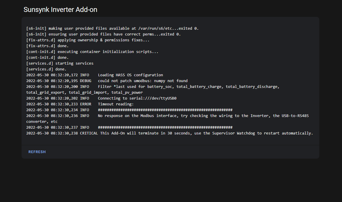

Hope you can help me, i bought the USB-to-RS485 adaptor dongle as per this page:
https://github.com/kellerza/sunsynk
Cable crimped and installed as per instructions,
Please see my configuration port addon
port:
serial:///dev/ttyUSB0
driver:
umodbus
swynsynkid:
2******
I get the following error in the log:
s6-init] making user provided files available at /var/run/s6/etc...exited 0.
[s6-init] ensuring user provided files have correct perms...exited 0.
[fix-attrs.d] applying ownership & permissions fixes...
[fix-attrs.d] done.
[cont-init.d] executing container initialization scripts...
[cont-init.d] done.
[services.d] starting services
[services.d] done.
2022-05-28 17:11:07,636 INFO    Loading HASS OS configuration
2022-05-28 17:11:07,653 DEBUG   could not patch umodbus: numpy not found
2022-05-28 17:11:07,658 INFO    Filter *last used for battery_soc, total_battery_charge, total_battery_discharge, total_grid_export, total_grid_import, total_pv_power
2022-05-28 17:11:07,659 INFO    Connecting to serial:///dev/ttyUSB0
2022-05-28 17:11:17,689 ERROR   Timeout reading:
2022-05-28 17:11:17,689 INFO    ############################################################
2022-05-28 17:11:17,690 INFO    No response on the Modbus interface, try checking the wiring to the Inverter, the USB-to-RS485 converter, etc
2022-05-28 17:11:17,690 INFO    ############################################################
2022-05-28 17:11:17,690 CRITICAL This Add-On will terminate in 30 seconds, use the Supervisor Watchdog to restart automatically.
[cmd] ./run.py exited 0
[cont-finish.d] executing container finish scripts...
[cont-finish.d] done.
[s6-finish] waiting for services.
[s6-finish] sending all processes the TERM signal.
In the Terminal i can see
/dev/ttyUSB0
Hope you can assit
@Marius Schonken
You want to check that your USB adapter is being recognised and that you have the correct address for i.
In Home assistant go to settings > system > hardware and then click on the three dot hamburger menu on the top RHS. Click on all hardware and go down to USB for the info, should look something like this:
Some things you can try:
  1. Ensure your MODBUS_SERVER_ID matches what is configured on your inverter
  2. Ensure only a single connection is made to the serial port at any time (which seem to be /dev/ttyUSB0 from your screenshot)
  3. Check the cabling again (use a shorter cable/different cable while testing)

  File "/usr/src/app/./run.py", line 191, in read_sensors
    raise Exception(f"Multiple Modbus read errors: {err}") from err
Exception: Multiple Modbus read errors: (1,72,4) CRC validation failed.
[cmd] ./run.py exited 1
Edited by Marius Schonken
12 hours ago, Marius Schonken said:
Thank you for the advise above
i am now connected, but get incorrect readings form my battery, please see log file
Did you change the serial number to your inverters serial number in the setup?
If yes and all are your readings are wrong, I would check the cable.
