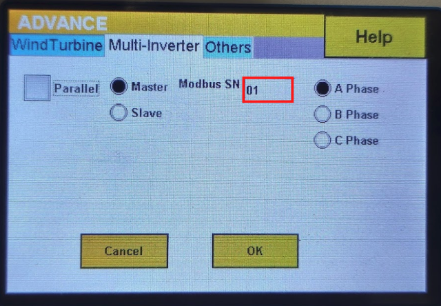

On 2022/03/19 at 7:39 PM, Hannesvz said:
The thing that fixed the inverter not speaking back to me was the modbus sn was set to 0, when I set it to 01 it fixed the issue immediately. For curiosity I tried to put it back to 0 and was unable to do so. @kellerza you should add to your github that people should remember to set the modbus sn to 01 < .  Thanks for helping me everyone. :)
Thanks - also been having issues trying to connect to my SunSynk.
I've just tested addresses 0-255, seems SunSynk only responds to the broadcast address 0.
Modbus RTU addresses are 1-255, with 0 being reserved for broadcast messages.
EDIT:
As mentioned by @_terminal below, the Modbus ID can be changed from the default broadcast 0 to another ID:
Edited by system32

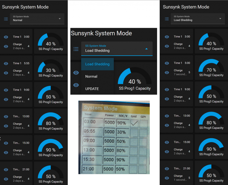

I'd like to get a better understanding of how the write feature works in your library / addon.  I didn't see much info in the docs.  What are you writing and how does it work from HA?
system_mode reads/writes the System Profile 😉 Which includes all these sensors.
In HA it is represented as a single dropdown/select control (see example screenshots)
The actual values in the presets are stored under /share/hass-addon-sunsynk on HA as yaml files. You can edit them and create new presets with different values. When you select UPDATE a file will be created with your current settings if that specific set of presets does not exist.
Then you simply rename the files, change basic parameters and UPDATE again.
In my example I change the time, capacity target % and charge from grid bit in slot 2. In slot 5 I simply allow charge from grid. To the left and the right you see other sensors I have included to visualize the system mode. (the system mode photo is simply one I had lying around and might not show 100% the values in HA)

@JGB Check on your inverter under Advanced -> Multi-Inverter. If Modbus SN is set to 00 change that to 01. This solved my timeout issue.
Edit: Likely not given you have an adapter that works.
Edited by _terminal
@_terminal Thanks. I tried to set the Modbus SN as suggested, but it didn't make a difference.

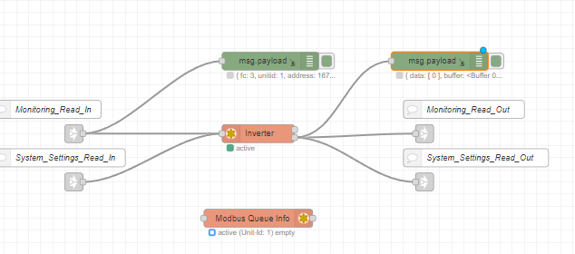

I assume that you connection is not working @McAllstar
Have you check in Node Red if the requests are being sent out?
I would start with adding 2 x debug nodes onto the Modbus read screens in Node Red and tick the system status and node status boxes so that is displays what is going on with nodes.
The inverter node should also be polling data to the inverter and should flash between active & queing. The Modbus Que info should also be changing value as the data is queued.
It should show you the requests being sent out to the inverter and then the response from the inverter.
If the requests are being sent out but your aren't getting any response.
- Check if the USB-RS485 adapter lights are flashing
If they are flashing then there is something wrong with either the cable or the connection somewhere between the adapter and the inverter. Plugged into wrong port, Ethenet cable wired up incorrectly, wires not connected properly etc.
If the adapter is not flashing then I would suspect that there is a problem with either the setup of the USB port in Node Red or the USB-RS485 adapter. I have had experience with USB ports on raspberry pi's moving around with /dev/ttyUSB0 not always being the same port so would check that first. Check the USB settings in the Inverter node and try changing it from 0 - 1 and see if that helps or plug the adapter into a different USB port.
If you are getting the data back from the inverter but can't see it in home assistant then I would check your database and MQTT settings.
Edited by Sc00bs
