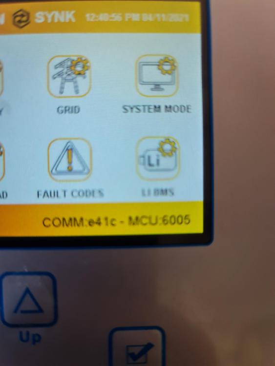

Denarius Posted November 3, 2021 Share Posted November 3, 2021 Hi Guys, my SunSynk firmware was upgraded to comm e41c and mcu 6006 which has caused the RS485 port to stop responding to modbus requests. It now seems completely unreadable. Did anyone else upgrade and get this issue? Quote Link to comment Share on other sites More sharing options...
Saliegh Posted November 3, 2021 Share Posted November 3, 2021 1 hour ago, Denarius said: Hi Guys, my SunSynk firmware was upgraded to comm e41c and mcu 6006 which has caused the RS485 port to stop responding to modbus requests. It now seems completely unreadable. Did anyone else upgrade and get this issue? I am running on a much different firmware version from that. Which SunSynk inverter do you have? Quote Link to comment Share on other sites More sharing options...
Denarius Posted November 3, 2021 Share Posted November 3, 2021 4 hours ago, Saliegh said: I am running on a much different firmware version from that. Which SunSynk inverter do you have? The 5kw. Which one are you running and what is the version? Quote Link to comment Share on other sites More sharing options...
PowerUser Posted November 3, 2021 Share Posted November 3, 2021 6 hours ago, Denarius said: Hi Guys, my SunSynk firmware was upgraded to comm e41c and mcu 6006 which has caused the RS485 port to stop responding to modbus requests. It now seems completely unreadable. Did anyone else upgrade and get this issue? When did you upgrade to this version? Is this very recent? You should log a case with their tech support for the modbus issue. Quote Link to comment Share on other sites More sharing options...

Denarius Posted November 4, 2021 Share Posted November 4, 2021 20 hours ago, Denarius said: The 5kw. Which one are you running and what is the version? Correction it's the 8kW, was thinking of MPPT array. I see there is a topic for this problem. Quote Link to comment Share on other sites More sharing options...

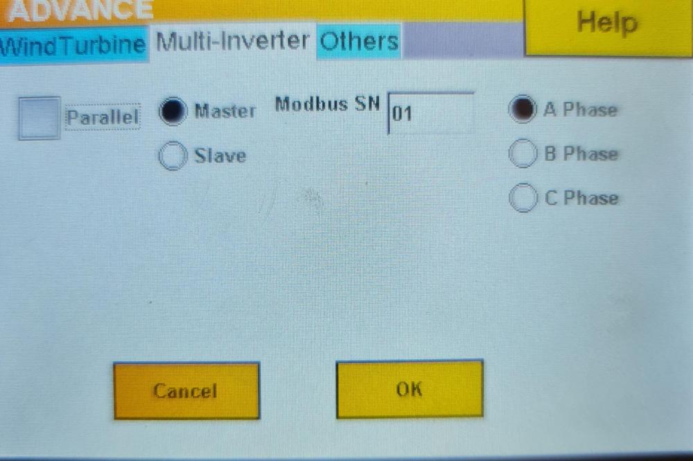

new2solar Posted November 4, 2021 Share Posted November 4, 2021 Had the same issue recently and implemented these settings (Modbus SN changed to 00 changed it to 01). It is still working. Sc00bs 1 Quote Link to comment Share on other sites More sharing options...

SolarAssistant Posted November 4, 2021 Share Posted November 4, 2021 On 2021/11/03 at 9:21 AM, Denarius said: Hi Guys, my SunSynk firmware was upgraded to comm e41c and mcu 6006 which has caused the RS485 port to stop responding to modbus requests. It now seems completely unreadable. Did anyone else upgrade and get this issue? What you have experienced as a bug is actually a feature. This firmware update allows you to read parallel inverters with a single RS485 adapter. Previously if you wired all the RS485 cables together and requested data on modbus address 1 all the inverters responded at the same time causing a corrupt response. You were forced to use an RS485 adapter for each inverter. With this update you can query the specific address you want a response from and only that inverter responds. This update is going to be disruptive since most inverters have their address set to 0 and many modbus utilities won't even allow querying on address 0. A changelog would have been really helpful. Quote Link to comment Share on other sites More sharing options...
abeetude Posted November 6, 2021 Share Posted November 6, 2021 On 2021/11/04 at 12:50 PM, new2solar said: Had the same issue recently and implemented these settings (Modbus SN changed to 00 changed it to 01). It is still working. How many inverters do you have? If only 1 is yours set to MASTER? Quote Link to comment Share on other sites More sharing options...

new2solar Posted November 10, 2021 Share Posted November 10, 2021 On 2021/11/06 at 8:20 AM, abeetude said: How many inverters do you have? If only 1 is yours set to MASTER? I only have 1 inverter and it is set to MASTER. Quote Link to comment Share on other sites More sharing options...
