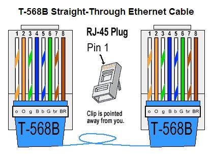

I've recently had a Sunsynk 5.5kw installed and I'm trying to collect data using the RS485 port without success. No matter what I try I can't collect data. I've tried the ports labelled RS485 and BMS 485.
I'm using the following rs485 to USB converters:
https://www.robotics.org.za/RS485-3P?search=rs485
The ethernet cable I'm running to the device is wired like this:
Cables 1 and 7 are connected to B and cables 2 and 8 are connected to B. I've tested the ethernet cable itself by crimping both ends and connecting my laptop to it.
After adding the flows node-red continuously tries to connect. When trying to connect using Python the minimalmodbus module the connection times out.
Does anyone have any other ideas?
I think it should be 1 and 8 together and 2 and 7 together. The diagram is correct on the below link, table is incorrect. Haven't started the project myself but reading up on it. But you can red the whole discussion where the guys found the solution.
