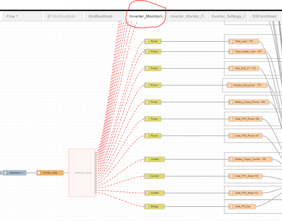

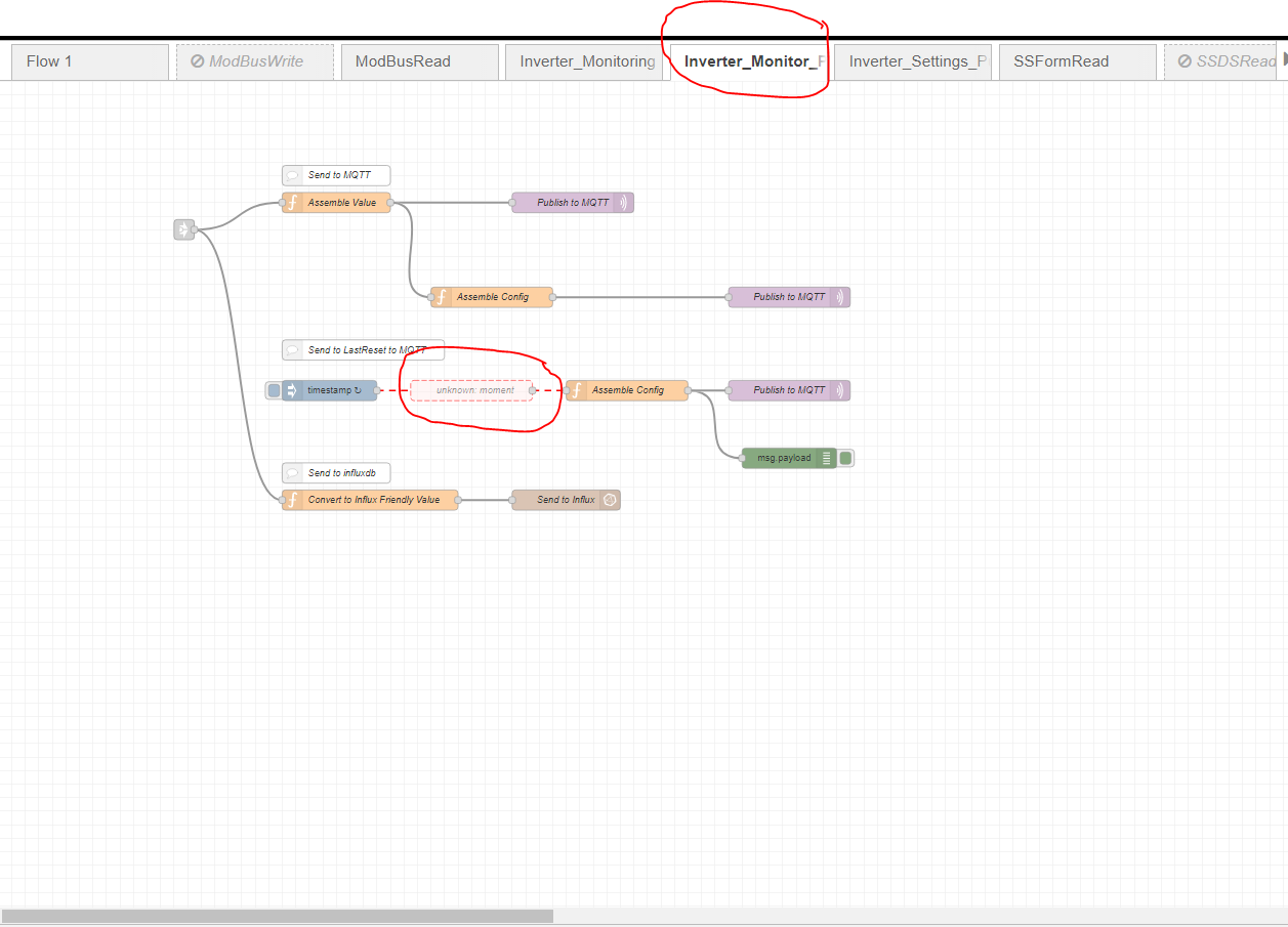

Hi @JeremyJvR
You need to download two additional nodes that are not pre-installed with NR.
Click the hamburger icon on the top right corner > click Manage Palette > Click Install tab. Search and install the following two nodes,
  • node-red-contrib-cycle
  • node-red-contrib-moment
That should resolve the issue.
On 2021/09/06 at 10:26 AM, Sc00bs said:
LOL, nope tried that already, still there.
@Bloubul7 is it the energy node in the Node Red flow that is causing this error?
Wondering if I maybe updated the Node Incorrectly, though I can't see much room for error
