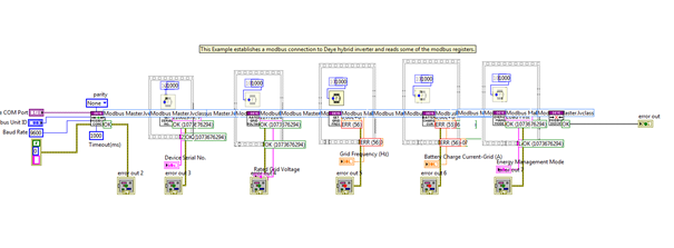

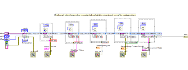

I am trying to read the Deye/SunSynk inverter using an USB to RS232 cable connected to my PC running a LabVIEW application.
The problem I am facing is that it doesn't work repeatedly. It is completely random when and which block executes succesfully.
Any ideas about what could be going on here?
Attached are two images that give a visual representation.

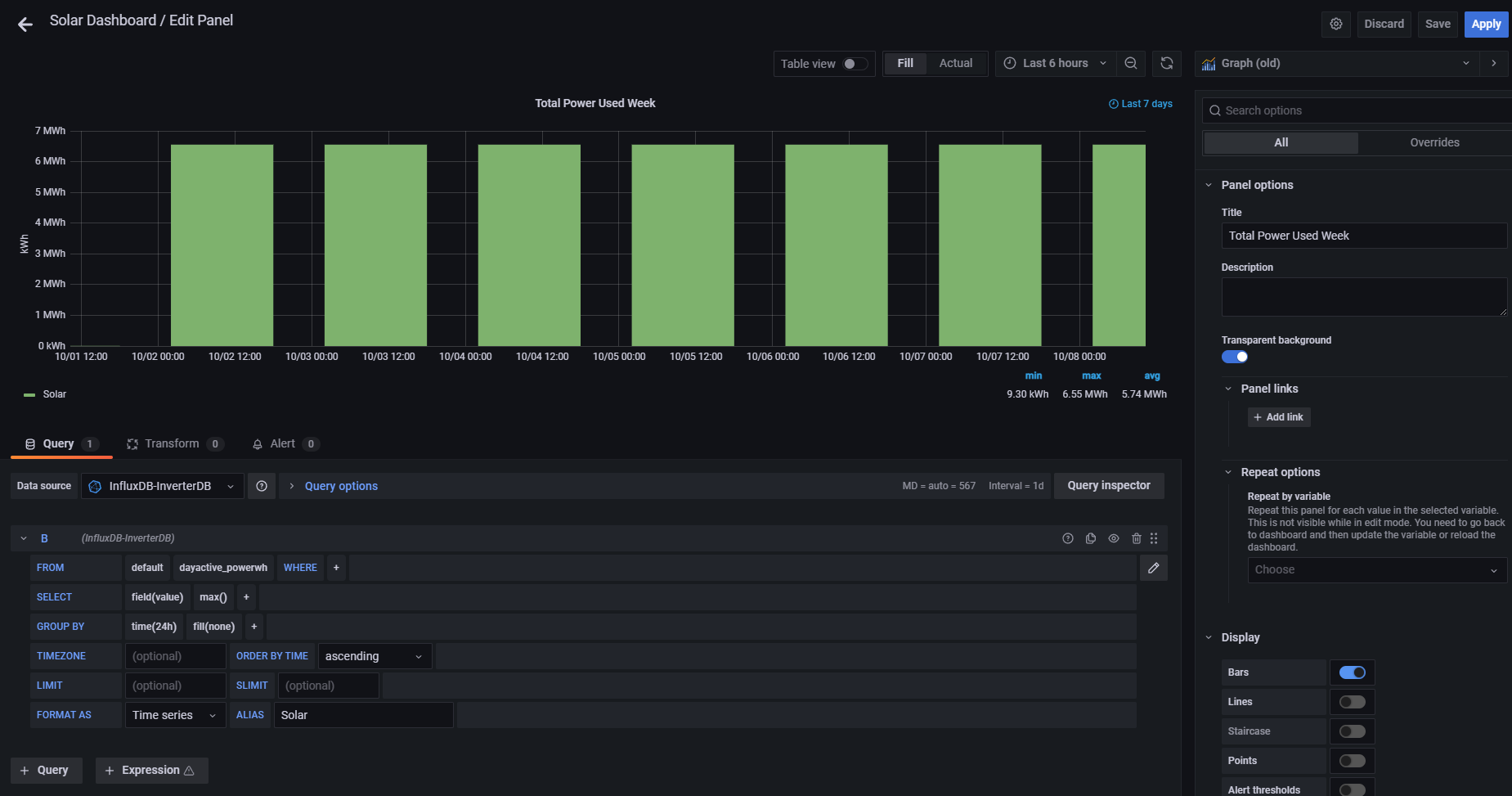

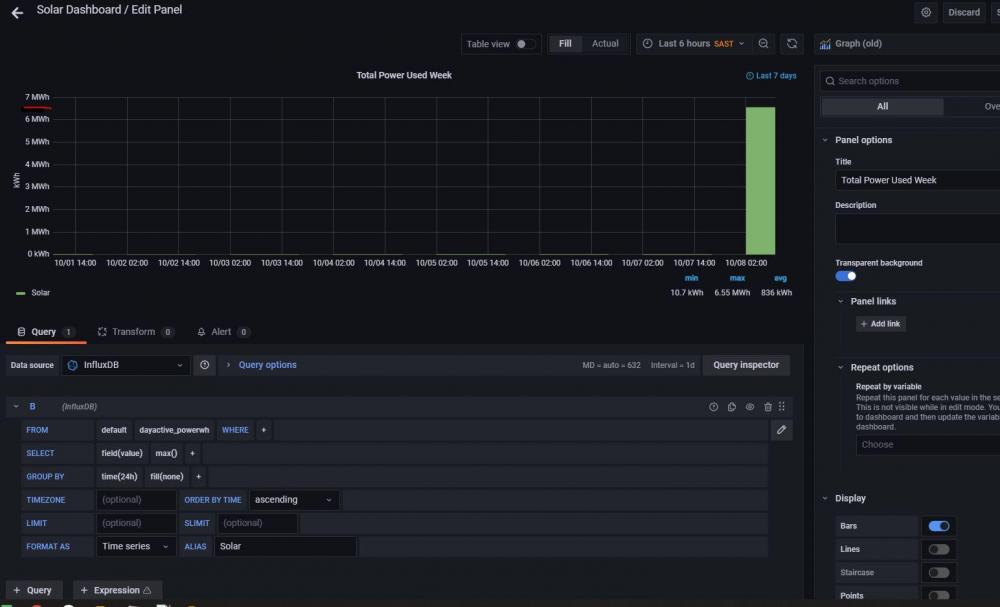

1 hour ago, Saliegh said:
Anybody else experience this? Data collection has been normal, until this morning when I saw 7MWh of solar generation for the day
Mine is the same as well,

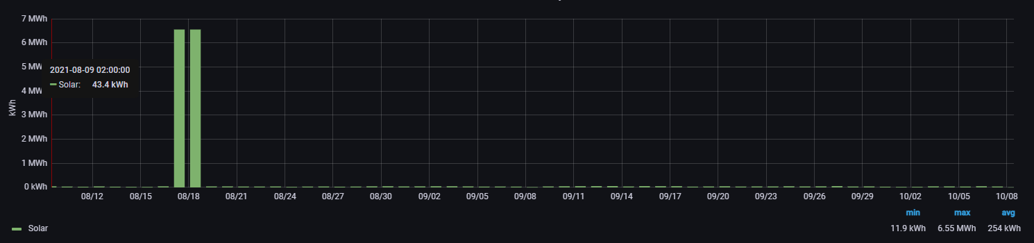

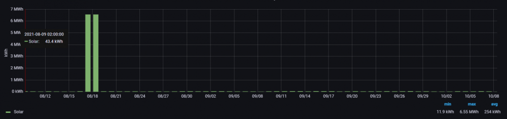

2 hours ago, Sc00bs said:
Had a look in my records and it has happened a few times to my data as well.
Interesting that they are all exactly the same figure i.e. 6.55Mwh
 That happens when the small nuclear reactor kicks in, inside your SunSynk inverters 🤣

My guess on the 6.55MWh thing is that the data is stored as a 16 bit unsigned integer (maximum value of 65535), with each discrete integer representing 0.1 kWh. That would mean that a very small negative number would wrap around from 0  to 65535, resulting in 65535 x 0.1 kWh = 6.55 MWh. Considering that the value seems to be for a whole day I would assume the problem is not at the storage backend, but rather somewhere between the inverter and node-red.
