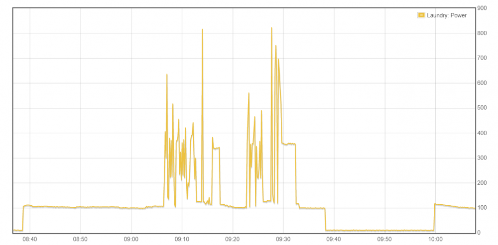

June 17, 20215 yr This is a graph of power usage of my Samsung 13Kg toploader with a cold wash only. 100 W is used by a fridge etc. Hope that helps ***EDIT *** The peaks are spinning / drying Edited June 17, 20215 yr by abeetude
