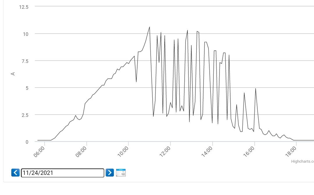

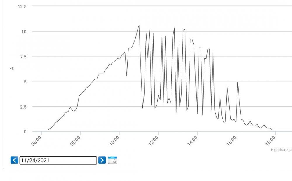

A major point remains. If you buy a quality 300W panel you should get 300W at irradiance of 1000W/sq m. No matter if poly or mono. In very cold weather a few days a year the mono MIGHT do beter but not worth a premium in price.
I have also not found mono to be smaller in the power range I am using. It might be at the below 200W level.
With my poly and mono series string I do get over 10A out of my lower current rating panels with a Imp of 8.7A during cloud edge.
