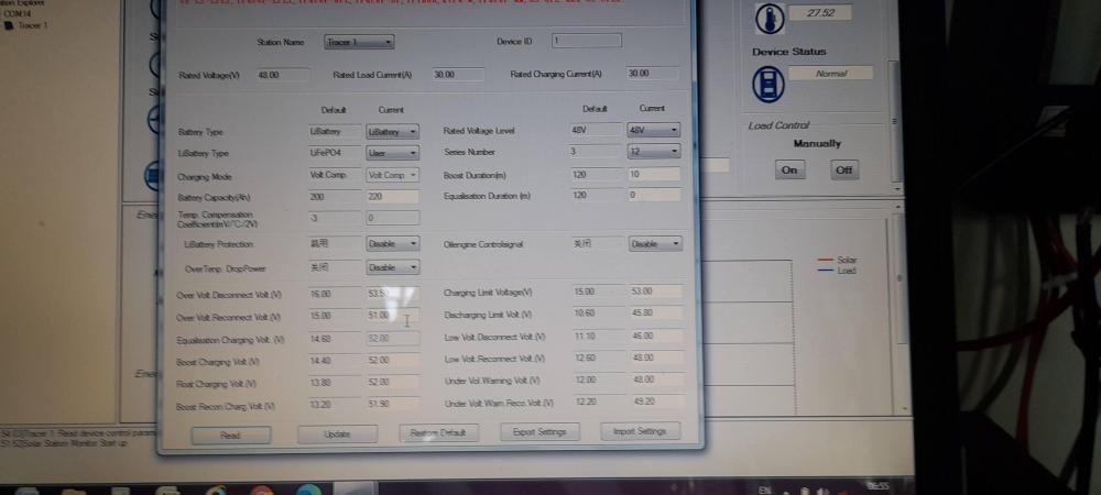

Chris could you perhaps explain your setup using the Epever with the Axpert MPPT.
Installed 1500Watt panels with Epever 30A mppt for extra capacity. Axpert and Epever connected to busbar with Pylontech battery's. Solar Assistant installed for control. Epever has it's own Lithuim charging program and is set to stop charging at 52v.
Thanks Chris. Interesting how your increased the charge rate with own panels via the Epever.
