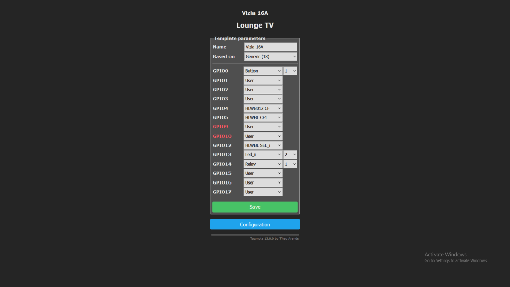

January 25, 20242 yr On 2024/01/22 at 4:15 PM, WannabeSolarSparky said: Last purchase Ordered 3 Aug 2023 still tasmotizable... I think this may be the last batch of the safe ones. https://www.takealot.com/vizia-smart-wifi-power-plug-switch-for-south-african-3-pin-16a-2/PLID90405537 I have ordered these and managed to flash Tasmota, but neither the relay nor the power measurement works. I suspect that the Template I used (Vizia 16A Power Monitoring Plug Configuration for Tasmota (blakadder.com)) must be wrong, which is odd as the board is dated 2018-12-07. Do you have access to a working one? If so, please could you let me have the template string that you are using? Thanks
January 25, 20242 yr Author 25 minutes ago, Calvin said: I have ordered these and managed to flash Tasmota, but neither the relay nor the power measurement works. I suspect that the Template I used (Vizia 16A Power Monitoring Plug Configuration for Tasmota (blakadder.com)) must be wrong, which is odd as the board is dated 2018-12-07. Do you have access to a working one? If so, please could you let me have the template string that you are using? Thanks
January 25, 20242 yr Author Here is a copy of my template {"NAME":"Vizia 16A","GPIO":[32,1,1,1,2688,2656,1,1,2624,321,224,1,1,1],"FLAG":0,"BASE":18}
January 25, 20242 yr Author Also follow the steps to calibrate the plug so that you get more accurate readings https://tasmota.github.io/docs/Power-Monitoring-Calibration/

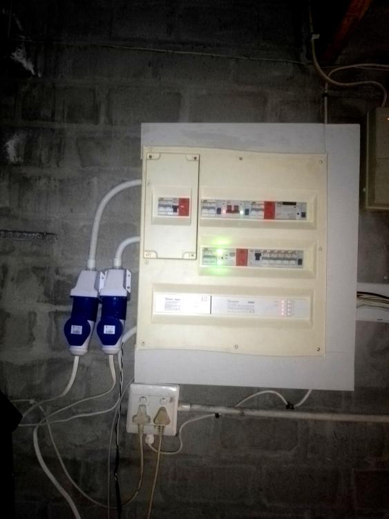

January 7, 20251 yr Hey @WannabeSolarSparky, How about sharing some pictures of your new DB and after "tidy up" project? This is what we have been busy with over the December period, a "Smart" borehole using Tasmotised CBi Astute isolators 🙂. Of course all managed with Home Assistant. The Energy Dash in HA is fantastic! As a side note, the CBi isolators are fantastic in front of a geyser and give you all the power information you need. Edited January 7, 20251 yr by SmartPad
January 7, 20251 yr Author 37 minutes ago, SmartPad said: How about sharing some pictures of your new DB and after "tidy up" project? Still awaiting 2 nvme drives to add to the pi5 nvme dual hat. Then I can put it into the db for photoshoot 😁 Here is the main db with the tasmotized SPM modules that feed data to the home assistant sunsynk flows on the essentials side.
