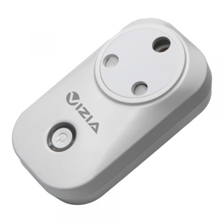

July 3, 20223 yr Author Visia 16amp Power monitoring Plug/socket tasmotized success Another one to add to the list that works if you are into this sort of thing. I bought one from takealot yesterday to test tasmotizing it. Works great.
September 27, 20223 yr On 2022/07/03 at 1:08 PM, WannabeSolarSparky said: I bought one from takealot yesterday to test tasmotizing it. 😂
September 27, 20223 yr Author 38 minutes ago, MKRandburg said: 😂 You only need minimal soldering skills And a bit of an understanding of how to use an esp8266 as a passthrough programmer SHout if you need need help
October 20, 20223 yr Hi, what APP are you using to display those graphs of the Vizia plugs ? I really want to get a plug that displays usage graphs for the last 24 hours.
October 20, 20223 yr Author 9 hours ago, AndreBam said: Hi, what APP are you using to display those graphs of the Vizia plugs ? I really want to get a plug that displays usage graphs for the last 24 hours. I use Node-red, gathering data via mqtt and modbuss from the tasmotised devices and then graphed onto my local thingsboard server.
