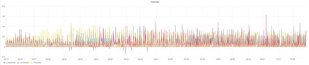

July 20, 20224 yr I have the 5kw and it blends with no issues quite high... as long as Eskom is around. When there is LOS / outage then you are limited to the 5KW (plus whatever limitations the batteries place on you). Very high level view of the last few months of my load
July 22, 20224 yr Author Thanks all! This is great! I should therefore be able to confidently go with the 5kW model if I leave ovens, pools and geysers off the essential side, and adjust our usage accoring to time-of-day. Going to the 5kW vs the 8kW is an extra R10k+ that can go into solar panels or battery storage - awesome!
