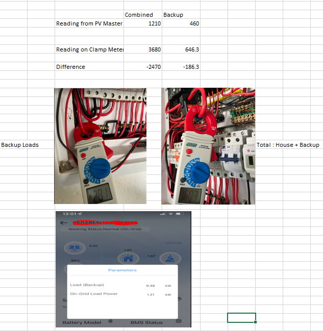

August 10, 20224 yr My experience recently and still ongoing : - Replaced 4 x 16VAC 50VA Alarm Transformers (R350. per pop) excuse the pun - Replaced 1 x Electric Fence AC Transformer - (R750.) - Replaced 1 x Battery charger board inside my gate motor. (R600) - Installer call out (R500) since he is a friend of the family I suspect the EZ meter is the guilty party here, but we will know once i receive the replacement meter to confirm and compare to my current meter Long story short, Meter reports lower current than actually on the circuits, once you start adding higher loads - kettle, oven, geyser, then the meter shoots up to where its not able to support those loads, but in reality the load have long passed the actual currents - in general i could see about 2.5-2.8Kw under reported by the Meter. More on this in a few days when i can give actual confirmation Hope this helps someone to investigate if you have similar experience
August 11, 20224 yr I don't think the easy meter could cause this. What is the voltage between earth and neutral on the backup side when loadshedding? Do you know if the earth leakage works when loadshedding?
August 11, 20224 yr 55 minutes ago, P1000 said: I don't think the easy meter could cause this. What is the voltage between earth and neutral on the backup side when loadshedding? Do you know if the earth leakage works when loadshedding? AC on Backup side N + E = 0.4 V when no load from the Grid
