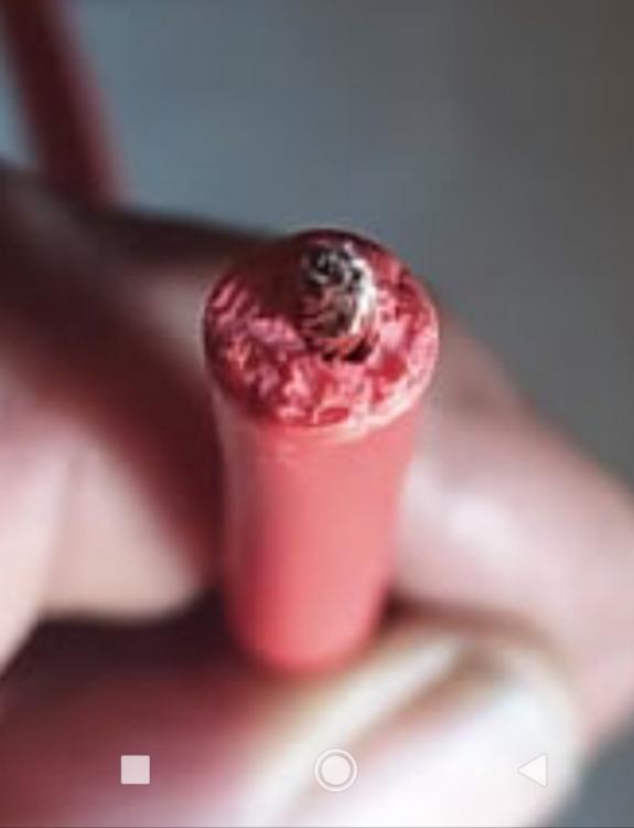

August 23, 20224 yr 1 hour ago, Beat said: Talking battery cables reminds me a story: Years ago a bought from Game a set of nice thick automotive battery jumper cables, guaranteed 200A. When it came to the emergency application they failed to start my engine. They only provided some charging current to my battery so I could after a while start the engine from my battery. I got suspicious and opened up one of the clamp handles. What I found was outrageous. The nice thick cables consisted of 99% insulation and just 1.4mm² copper. That copper was not even crimped to the clamp but only squeezed between the clamp and the insulation. I brought it back to customer service and got refunded. By the way, Midas sold the same product. I then bought 6m of 16mm² welding cable and soldered 3m each to the clamps. I could start with them a 2l diesel engine from a 50Ah battery. This is what I found used on a set of jumpers. Bought from Midas. Wire was about 3sq mm and plated with copper. It looked like aluminium wire. Edited August 23, 20224 yr by Scorp007

June 4, 20242 yr On 2022/08/23 at 12:26 PM, Scorp007 said: This is what I found used on a set of jumpers. Bought from Midas. Wire was about 3sq mm and plated with copper. It looked like aluminium wire. Need that super thick insulation to protect you from that 12V 😂

June 5, 20242 yr 17 hours ago, run_the_race said: Need that super thick insulation to protect you from that 12V 😂 The insulation is so thick to protect you from the red-hot aluminium...
