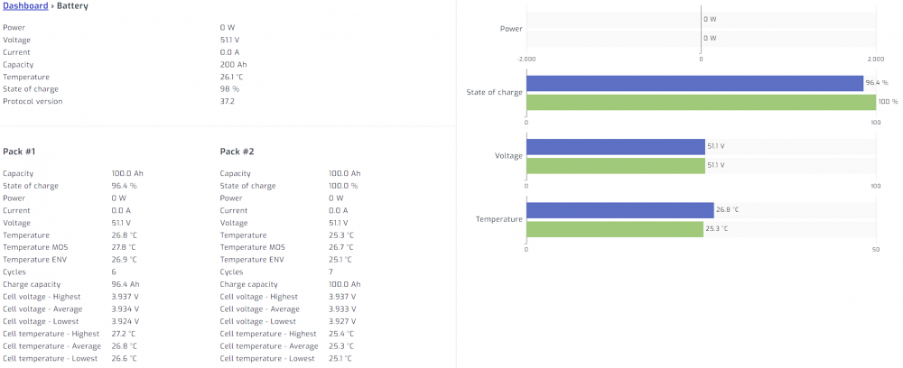

Hey Everyone,
Just reaching out for some help please. Im not sure If I should contact @HubbleLithium for some advice here or should there be something else I should be trying to fix this myself? These AM2's were installed 4 days ago and Im noticing some weird numbers with one of the banks on SolarAssistant. Could anyone who has gone through the same with these batteries before?

The SOC/Capacity numbers can be a bit odd till they've been fully discharged and recharged
Also are your voltages set correctly? (Take a look at the sticker on the batteries) That voltage seems a bit low for "fully" charged

I am doing my homework at the moment with everything as we speak as well. Im currently busy with the reset - https://hubblelithium.freshdesk.com/support/solutions/articles/151000003441-how-to-reset-comms-at-100-soc to get the 100% SOC. Im then going to go through the Hubble Sticker and align the settings on the Lux.

This is my start of the day
So Im only using my setup for Backup power at the moment till we can run with solar later down the line. I dont have any need to discharge them other than during loadshedding. So since I got the battery, pack 1 was not hitting max state of charge and was constantly behind pack 2. I then done the whole AGM setting to balance the voltages and get both banks up to 100%. I did that yesterday, that worked great. This was after the balancing.
The LuxPower then when connected back to Lithium mode immediately started to discharge the batteries, despite the AC charge being 00:00 till 23:59. Seen in the above image by the "draw" happening on both banks.
So I left it thinking its the BMS resetting things. This then happened the entire night, up and down which doesn't look like its expected?
Anyways we had load shedding twice this morning and again the batteries are unbalanced by nearly 5%.
