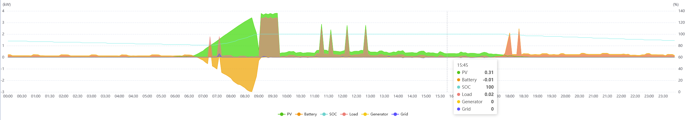

How much power does my SS5kw draw?

Just to add. It was using between 40 and 80w up until some time last week. No changes. Tried requesting an update of the FW which was done this morning some time it seems but hasnt helped in terms of the additional draw of the inverter...

its almost as if the efficiency of the inverter has dropped and the losses when converting seem to be the difference i am seeing? if this is the case then thats quite concerning. the differences now is at almost 300w.
