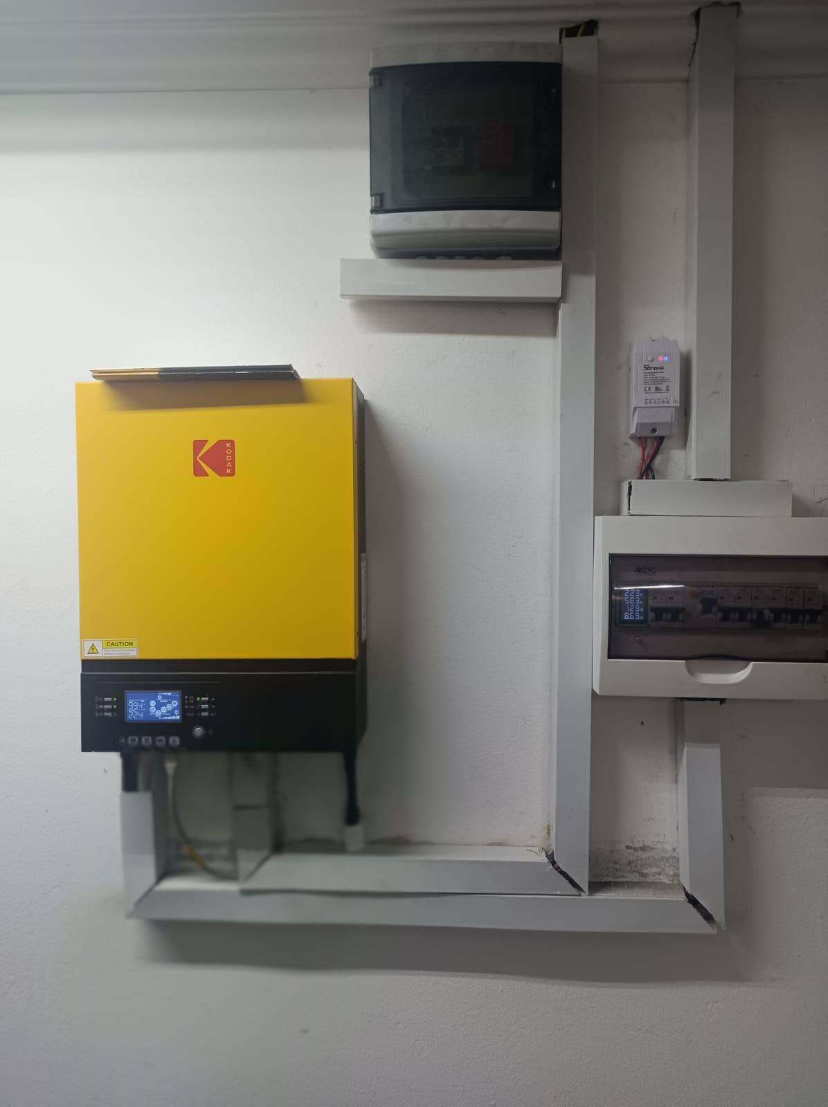

An electrician friend helped me with the install. We decided to split up our DB board and run certain items permanently from the inverter. These include all the lights which are LED, the 1 fridge, tv, media box, fibre router, alarm, garage motor, gate motor and a few extra plugs for the office and charging of phones, laptops and tablets.

You have a neat install, well done.
A 5K inverter will do all of that, and yes, you can always sell your old kit to a grateful buyer, at a discount obviously. But I am impressed with your start, your positivity and your optimism. Most of all your desire to do things properly. It proves that everyone's solar  alternative energy journey is their own. Nobody can dictate one's needs, but we all can predict (with astonishing accuracy) what the wants are / could be.

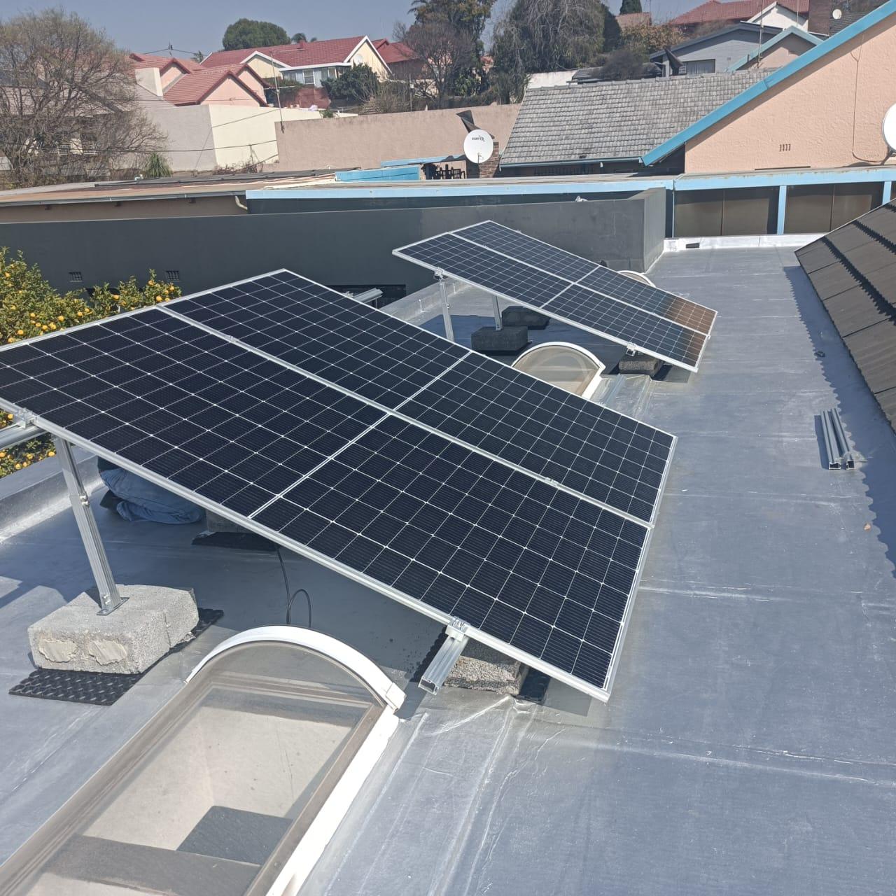

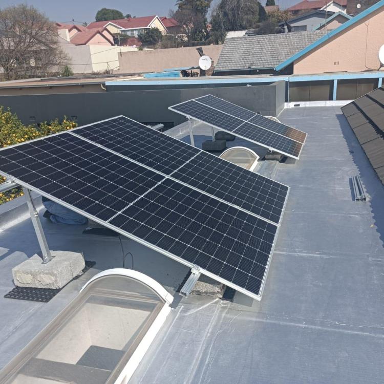

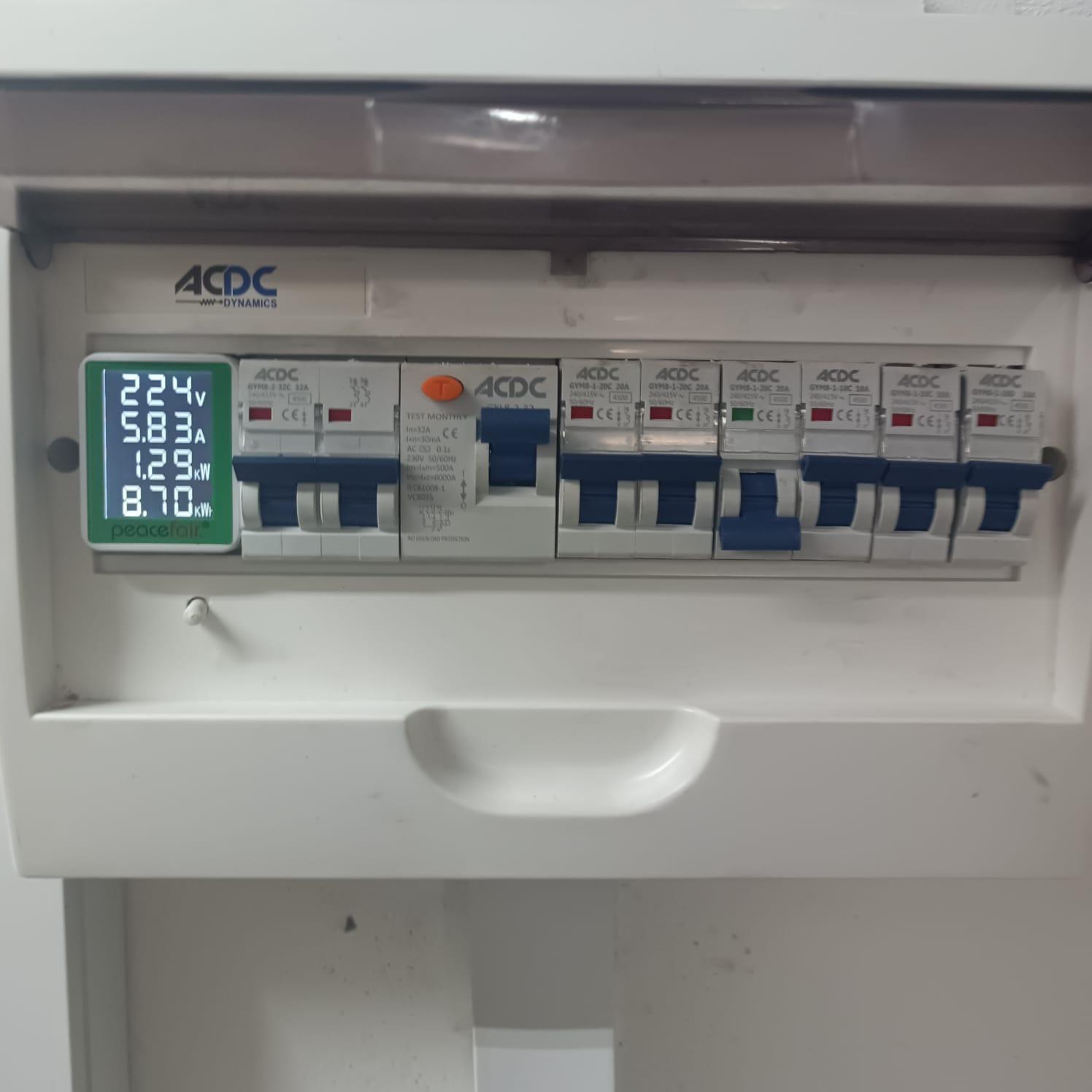

First of I separated AC and DC wires from original install. Also added mains and EL breaker plus a watt meter to my essentials DB. Top DB is PV combiner.

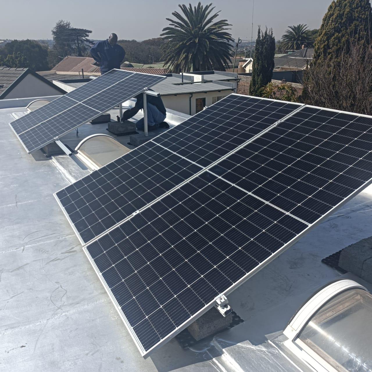

The panels we added was 4 off Canadian solar 550w panels. They are weighed down with cement blocks as we cannot fasten them to the roof due to the waterproofing.

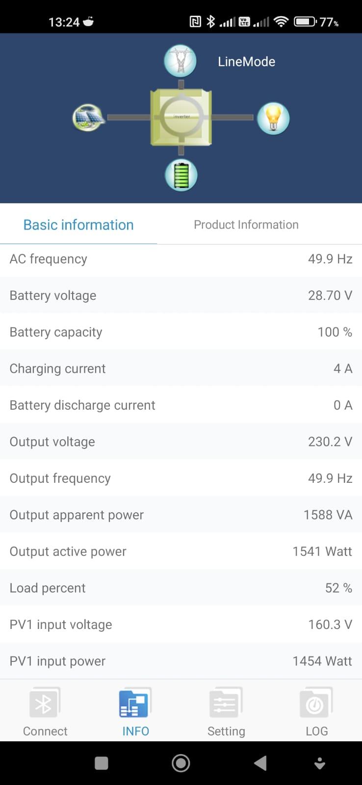

Performance is good, can carry load from solar, but there are some issues being discussed here If it ever gets solved it will be updated on that post.

3 minutes ago, Crankshaft said:
I'd put some large dollops of adhesive under those cement block.
They may be heavy, but the wind can be stronger.
Unfortunately we can't. The blocks need to be moved for the waterproofing maintenance.
According to my calculations we will need a wind of over 60km/h to move the panels. The highest wind speed recorded in our area was 26km/h.

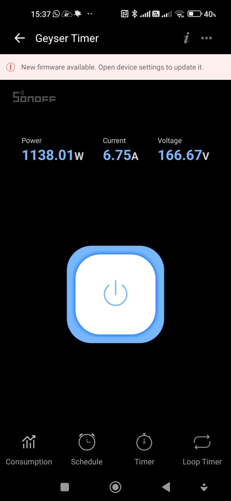

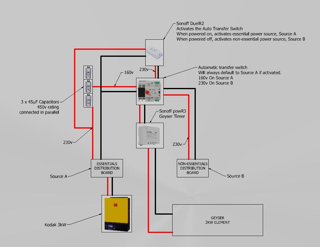

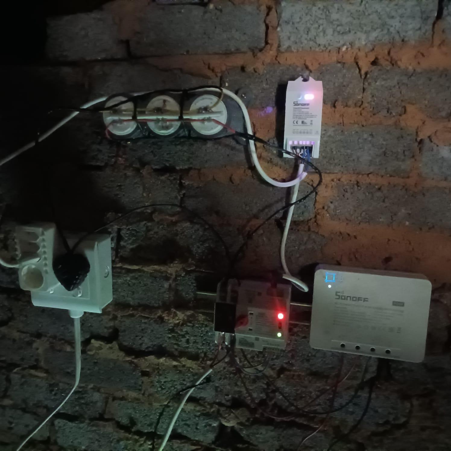

So 1 final mod to our system. I derated the geyser element to run at around 1 kw via the inverter, and with an automatic changeover switch I can run it at 2kw from Eskom power. Everything is controlled via eWelink so I can manage it from my phone. Here is a sketch of the circuit. I will be adding a Sonoff loadshedding detector at a later stage to switch geyser and pool pump off when mains aren't available. This will save strain on my battery. Reason being can be found here

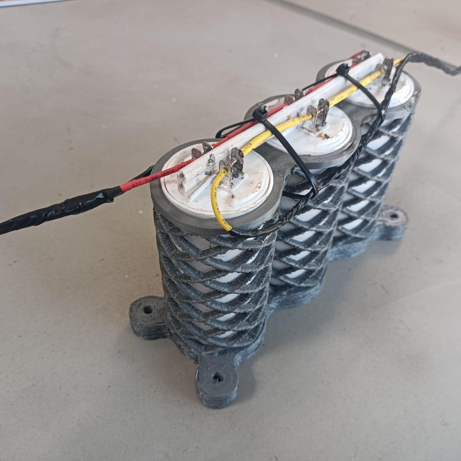

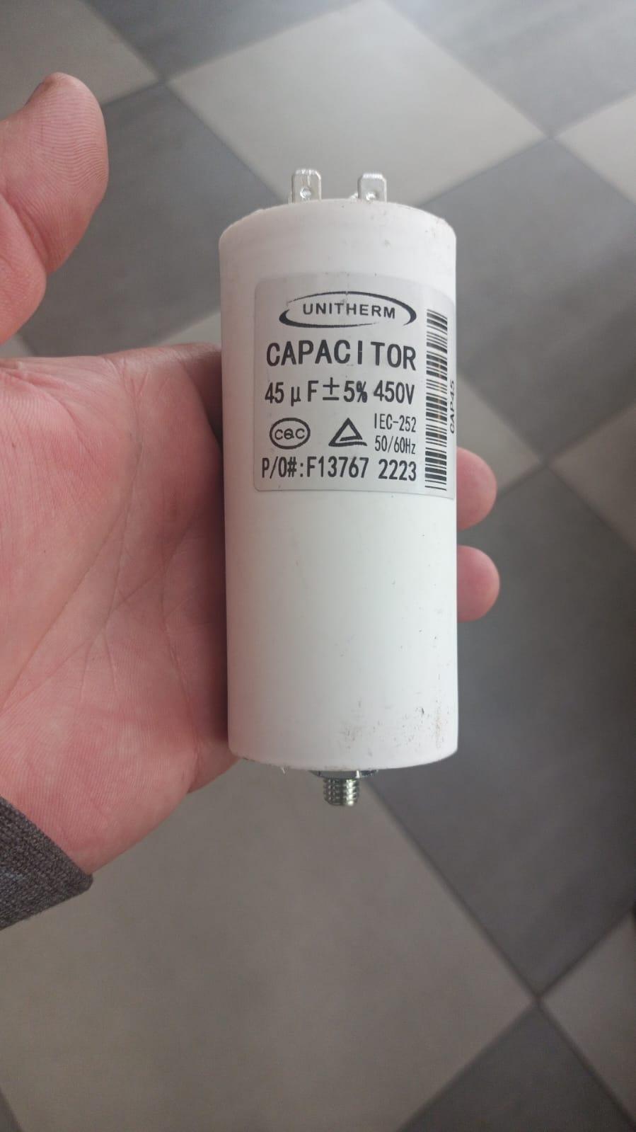

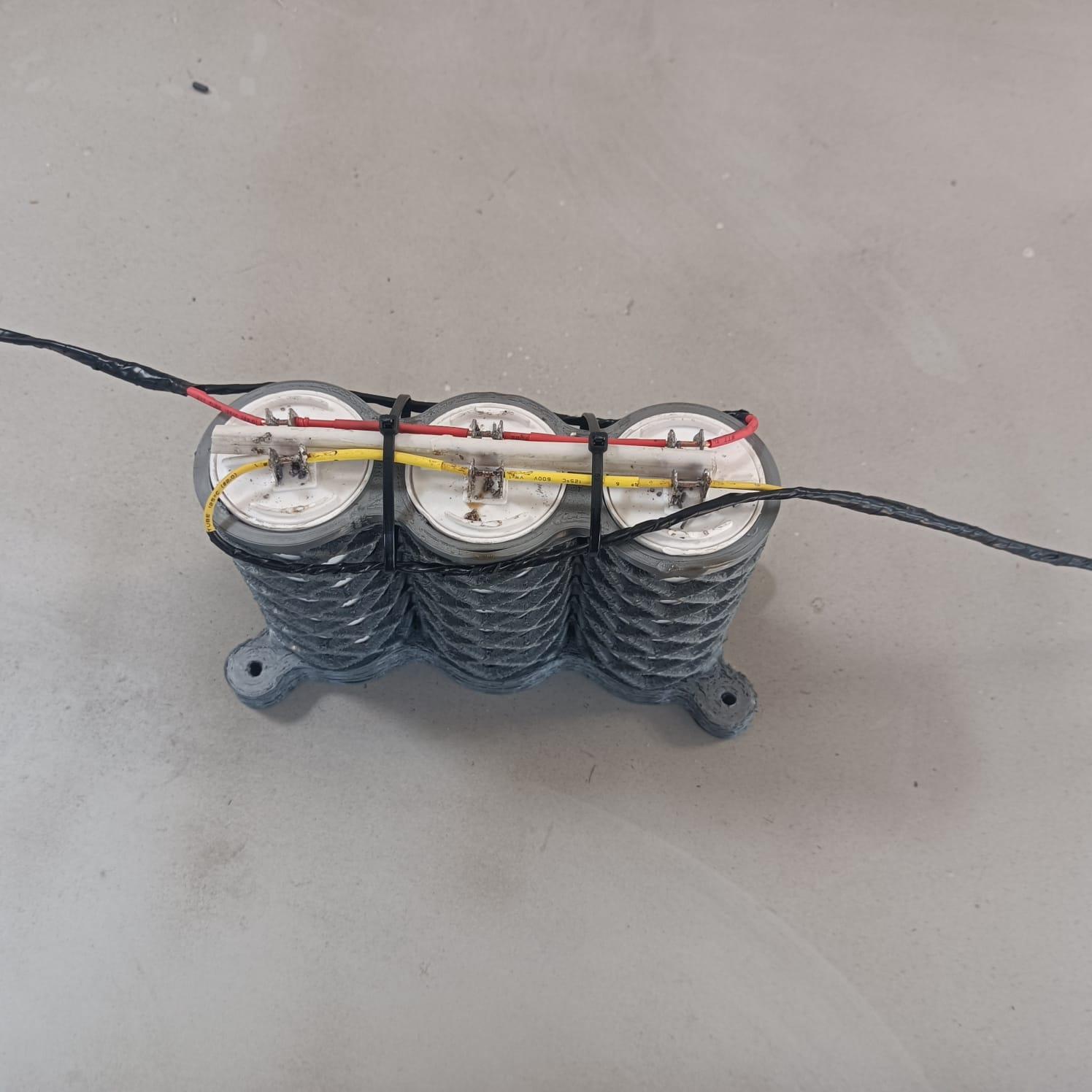

3 capacitors in 3D printed housing, I know it doesn't look pretty but it will be in the roof and no one will see it. Unfortunately I ran out of red insulation tape and heat shrink, otherwise I would have used that instead of the black and yellow. i did add a little solder to each terminal to ensure solid connection between wire and capacitor. Extra piece of insulation between the capacitor poles for added protection.
Install in roof.
Geyser running via Eskom
Geyser running via inverter
Amazing innovation and great results. I feel compelled to ask though, do those capacitors gets extremely hot? Did a thermal check?
For some reason, and likely extremely unwarranted, I just can't shake the sense that you've just amplified your risk for a house fire :D
Not at all. They have been running now for a solid hour and still cool to the touch. They are quite beefy so not worried.
Well done! When the geyser runs off the inverter, do you notice any change in power factor?

Will have a look a little later, I do have a wattmeter that measures power factor aswell.

Will have a look a little later, I do have a wattmeter that measures power factor aswell. Currently its measuring on my PC and 3D printer with a power factor of 0,65 and we are experiencing loadshedding. It will probably be the same for the geyser but will double check
I got too lazy to do the math but I would expect a slightly leading power factor for the geyser.
