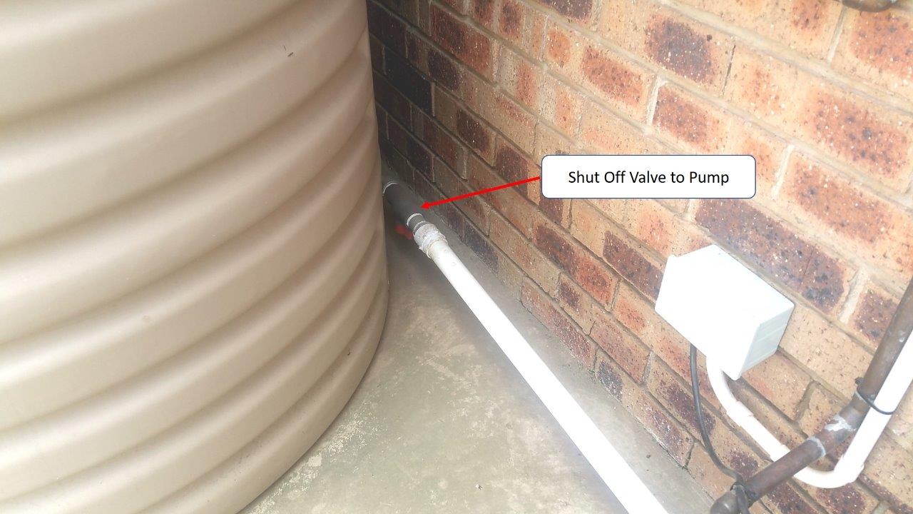

Hi @gabriel. Here are some pics of my setup. I tried to keep it simple. I manage my system with cut off valves only.
To start off with, I brought the municipal water input line from the other side of the house to close proximity of the water tank. I brought in a new line and disconnected everything feeding the house in the roof. Now I have a common feed line feeding the house. By opening or closing a valves I switch between feeding from Municipal water or from the Water tank.
1.) Valve 1 Open and Valve 2 Closed - Feed from Municipal water.
2.) Valve 1 Closed and Valve 2 Open - Feed from Water Tank.
3.) Valve 3 gives you the option to fill the tank with Municipal water or shut it down.
4.) I drilled a hole on the side of the water tank at the top and fitted a toilet ball valve on the inlet side. That way you can keep the tank filled at all times without opening or closing valves manually. Every 3-4 months I close the inlet valve to the tank (Valve 3) and switch to Water Tank Mode. Then I run on the pump until the tank is empty and then refill it with fresh water.
20170804_122349.thumb.jpg.35c37128fbdb460032bd78681abdbe0a.jpg20170804_122938.thumb.jpg.e2e82956e5d614ccf3915edbb5b2282a.jpg
verrrrry neat setup @Don, i note you have no pressure tank, does that have any influence on the house water pressure? how long has your pump been doing its 'thing'? is the pump noisy [i ask cause you bricked a window over there ;-)]

Thanks @gabriel. No, I have no pressure tank. My pump pressure is set at 5 Bar, which is slightly higher than the Municipal pressure. I therefore have more pressure running off the pump than when on Municipal water. When on the pump, you need to open a tap slowly until the pump kicks in and then open it further. If you just open the tap halfway and the pump kicks in a second later, you have water all over the show and dripping from the ceiling.
No, the pump is not noisy at all. You might hear it late at night when it is very quit trying to fall asleep and someone flushes a toilet. Yes, I had a window in our dressing room opening where the tank is standing now. You open the window and you stare at the water tank in front of the window. So I bricked up the window.
I installed the water tank and pump about a year ago and works like a dream. Just make sure you don't have any toilets that don't seal properly. Otherwise you have a pump that stop/starts every 5 minutes. running for 5-10 seconds to pressurize the water system.
