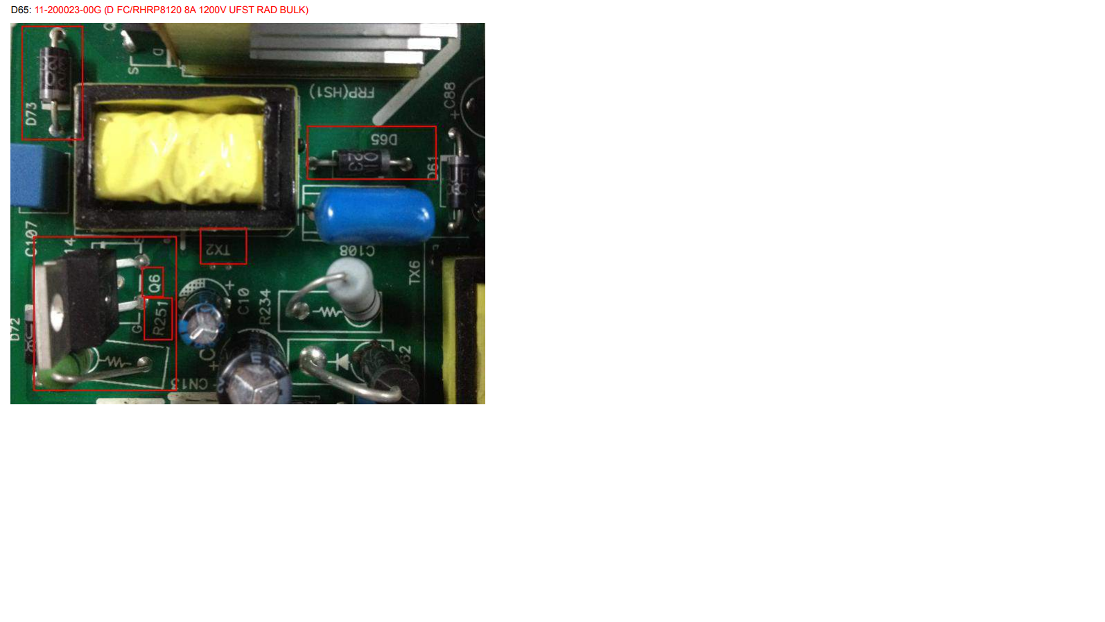

9 minutes ago, Gerlach said:
on the Must they use Transistor FAIR/RHRP8120 8A1200V TO-220
Err, I think you mean diode.
It seems to be the same thing (maybe a different brand) in a different package. Just a matter of availability, I think.
Well spotted!

Thank for the correction there, actually there mistake from there side. Top pick is the Must inverter and bottom one the Voltronic one. Busy checking everything in both manuals and will test tonight to see what needs to be replace. Will make a list of all the stuff.
Edited by Gerlach
Must do seem to be a little sloppier, e.g. the transistor thing you found above, and I noticed them labelling the middle lead of an IGBT as an Emitter (middle/case is always collector). Well, it wasn't totally clear, they only labelled two of the three leads.
Looks like they do their own PCB layout as well. I wondered whether clones would copy the layout as well as the circuit.
Jip, I spotted some things to that was different. On the Copy part, all the board layout numbers looks the same, but the layouts is on different spots. Wonder if someone on the forum got a MUST unit that they can maybe open and take a close photo for us.
@Coulomb Update. Soldered Q6 out and R251 and soldered pin 2 and 4 to out on XT2. Q6 is working when i tested on my meter, R251 is fine and XT2 i got a 3Ohm reading, but i think i will still replace them, i just need to check where I can locally find XT2.
I solder everything back and still got the error 9 code, so will replace all the stuff in that circuit part. What does D65 and D73 do and do have maybe info on them, Thinking to replace them to.

Thanks for the heads up, but i jump the gun to fast. Strip out the parts the same day that I got the board, and solder them in, started the inverter up, everything switch on, but still error 9 and then I got a burning smell, pulled everything  out really fast to switch of the unit. I think Q6 the mosfet is toasted "tested it". Under close inspection i spotted that the mosfet that was on my board had a different  code on then the other board one. The EEL16 transformer is the same code on the paper and is till working. I will solder the old mosfer back because that one is still working.
Something that i spotted to is, D65 in MPPSOLAR manual "the pic" and the part number is different, the MUST unit and the Axpert unit is using the same part .
