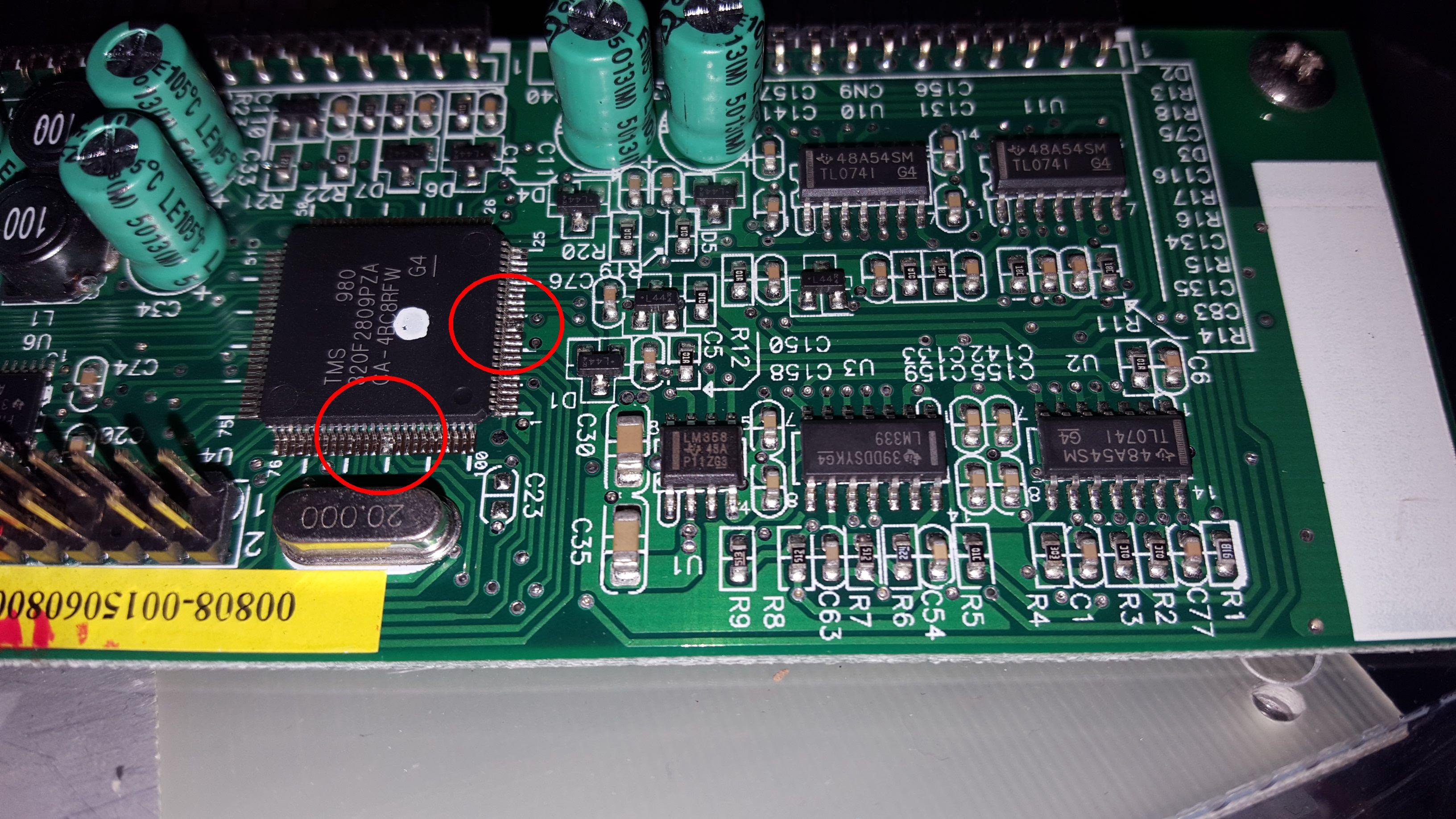

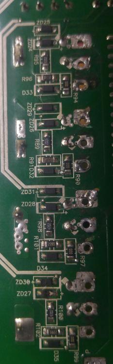

Thanks for the help there @Coulomb I really appreciate it.   I took some photos, can you maybe check and point out for me where i must check on the mother board.
Sorry to jump the queue, but it seems there's some solder bridges on the components I marked in red. Do you have a fine tipped soldering iron, perhaps you can clean those pins up?
On the 2nd image, on the right circle, that one pin seems a bit short. Is it loose or broken?

Ah. The smaller board is the daughter board; the much larger main board that it plugs into is the mother board. Sorry for the confusion.
@SilverNodashi, those solder bridges are presumably normal. There are several pairs of pins on the processor chip that connect to the same place. I don't see evidence of problems with the control (daughter) board at this point.
The area of interest will be under the main board, near multi winding inductor TX2 (large chunk of ferrite with yellow tape over the windings).
I wish I had a board to photograph, or photos of that part of the board, but I don't.
