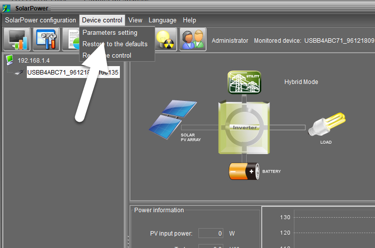

On ‎21‎/‎02‎/‎2016 at 11:53 AM, Prasert1965 said:
Hi MaurioZa
I had set up Wide ac input range to enable. But the software not allow to change it.
Now I find the method to change from another forum.
Dear Prasert1965
I'm facing the same seeting error for different settings.Could you share the method with us to resolve this problem?
p.s
My infini unit is not plusk but simple 3kw.
Best regards and thanks to all of you guys.

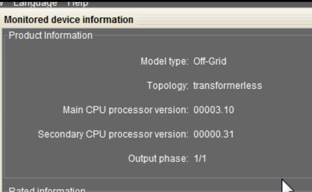

I don't think Prasert1965 has found a way yet.
what's your firmware version?
IMO unless you have firmware version which supports new settings you cannot enable those settings.
