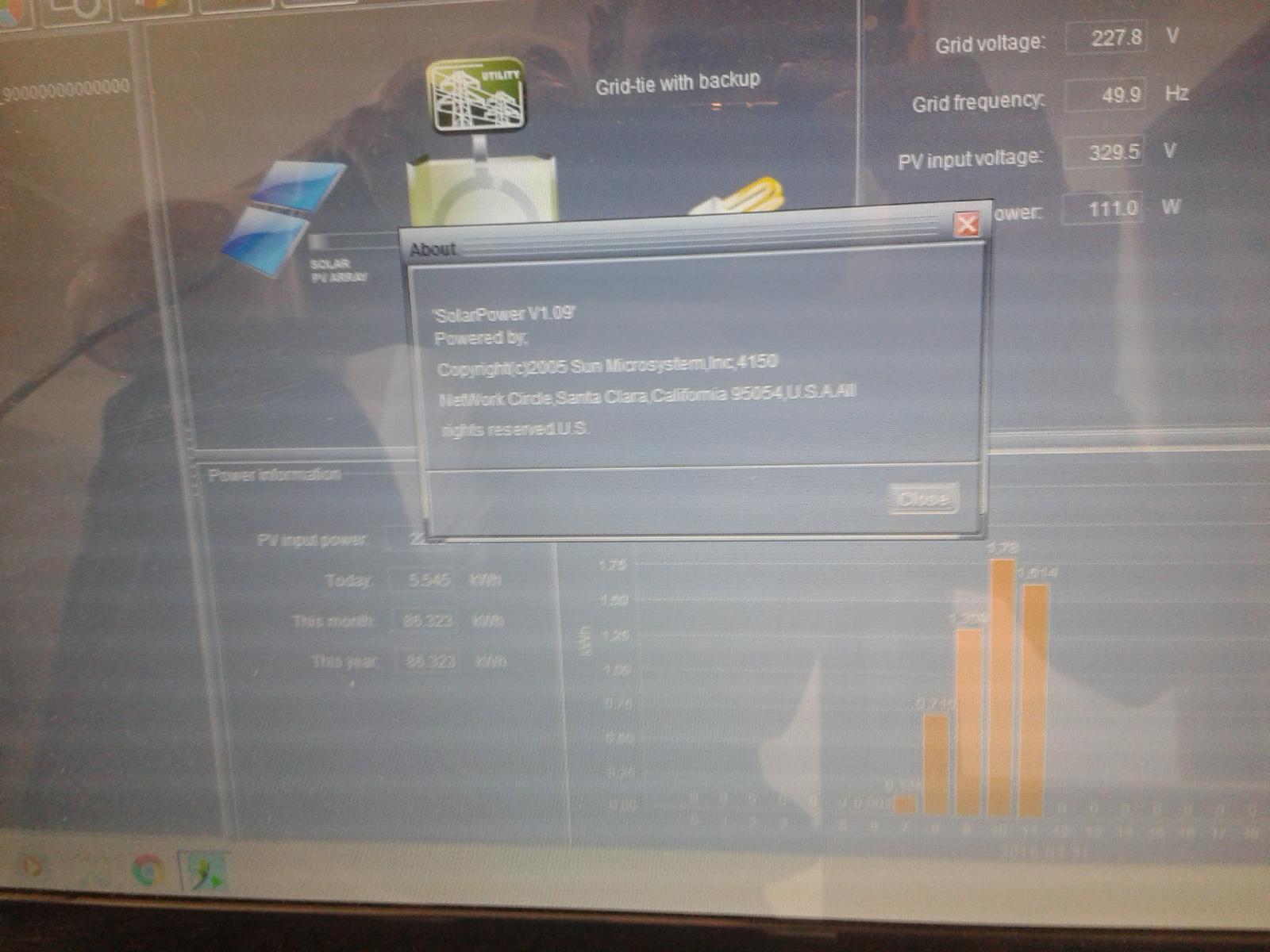

in perfect agreement with " crappy bundled software ". Also I am still using SolarPower v 1.07 because i am a little wary of upgrading to a version which might be not compatible with firmware (excuses: factory a few days ago has sent me a new version V1.08 which I have been too lazy to install).

If I recall correctly, JDP mentioned that some warnings were not handled correctly in the Axpert software. Warnings were logged although the errors did not actually occur - they are again bugs in the software and he filtered / corrected that issue in his software for the Axpert.  I will not be surprised if it is a similar thing here. I think in the Axpert's case it was a fan failure message which occasionally occured
I'm on v1.10 and still experience issues with it.

If you get the fault and the next second the fault is cleared you can assume it was a wrong string value.
