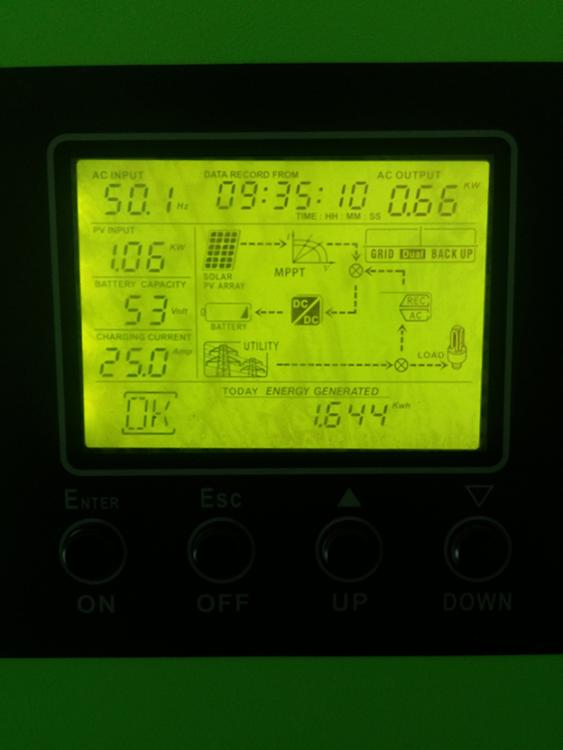

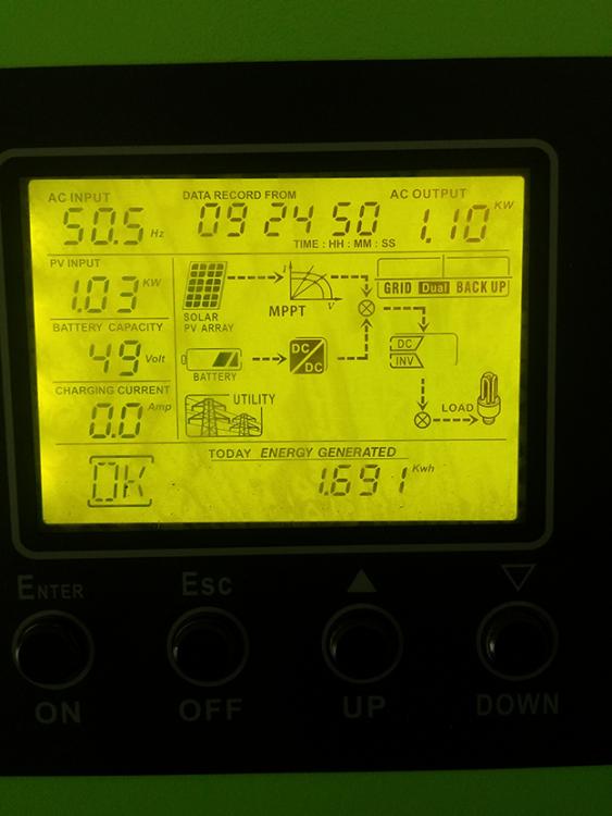

I had a similar problem. Every now and again I noticed that the PV power dropped quite a lot for a few minutes at a time while the skies are clear and the sun shines bright. My only thought was that one of these huge birds in our area (I don't know what they are, but they are huge and so are their no.2's) camped out on a panel and caused partial shading - as you know partial shading / covering one cell has a huge impact when you have only 1 serial string of panels. It is quite easy to get on to the roof and usually whenever I noticed this behavior I would grab the ladder and go check the panels, but to my surprise I never spotted a bird, there was no partial shading and no no.2's covering enough of any of the cells to cause the drop in PV, so I always thought that it might have been a bird and it flew away before I got to the panels.
Then about a month ago on the Sunday morning I walked through the garage again and noticed the same behavior - a drop in inverter fan speed usually indicates lower PV power. I grabbed the ladder again and again found nothing out of the ordinary on any of the panels, but this time when I got back to the inverter the PV was still low.
I then switched on the PC and checked the settings and the logs and then spotted the "Grid frequency upper limit reached" warning and noticed that the grid frequency was at 50.2 Hz and the upper limit was set to 50.1 Hz. Needless to say, as soon as I've changed the upper limit to 50.3 Hz, the PV power shot up and the inverter started feeding to the grid again.
The verdict - the lower overall grid load on the Sunday morning caused the grid frequency to rise which caused the inverter to stop feeding back.

5 minutes ago, MaurizioZA said:
I did not try if software accepts any parameter outside range but I would imagine not
Yes, you are correct, the software limits the ranges. Another question is if the inverter would accept values outside the ranges - I have not tried that though.

Thanks Again. i Applied the password last night and it worked. i have altered the Max. Frequency from 50.1 to 50.7. this was enough for me inverter to stay on Grid all night during on grid times.
19 hours ago, MaurizioZA said:
For example I was having trouble with min and max AC INPUT FREQUENCY. Although device supports a range between 40 and 55Hz I found that altering the range between 47.6 and 50.4Hz was perfectly sufficient for me.
yes u r right. i made minor change from 50.1 to 50.7 in Max Frequency only.
