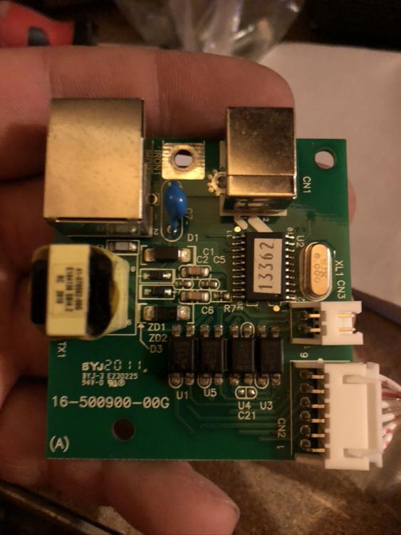

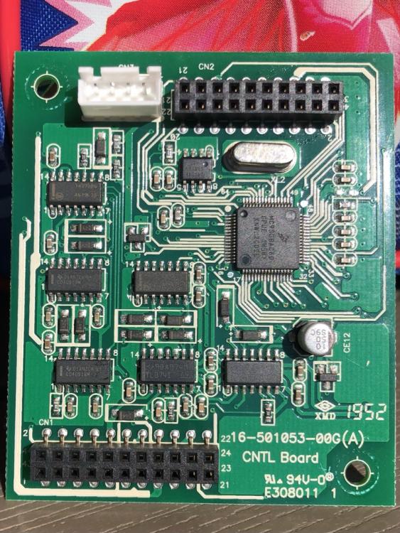

October 14, 20205 yr Hello, I had a bad experience with my "easun 3kva mppt ... " wich seems to be the same hardware as axpert VM II series. After a rain with lot of lightnings my inverter went off with warning "20" ont its display. The error isn't in the manual. It does not start anymore, but I searched for problems and found 2 faulty boards. 1. the communication board ( D2 burned ) PN:16-500900-00G 2. the CNTL Board PN:16-501053-00G Please let me know if anyone could help me buy this boards ( especially the CNTL Board ) because I can't use the inverter anymore. I am from Romania but I am willing to pay for shipping without problem. Thanks a lot for your future support.

October 15, 20205 yr On 2020/10/09 at 4:34 PM, Coulomb said: Indeed. A sadly common problem with the comms boards is that the small transformer (technically a multi-winding inductor) overheats and there are shorted turns. Those transformers are one of the very few components that you can't order from an electronic component supplier; they are all custom wound. Check for discolouration of the transformer (the thing with yellow tape on it). I've heard of people obtaining replacement communications boards from Ebay or the like. Fortunately, the comms boards haven't changed in function all that much, so one from a slightly different model should be fine (as long as it has the right connectors). After reading your post, I tried with another comms board from another Inverter that I had at home. I checked and the two internal connections were the same, so I've tried but unfortunately doesn´t work. Also, I had checked the yellow film around the original comms board transformer and it looks good, however, the hot summer temps could likely overheat anything.

December 16, 20223 yr Привет,Вы нашли плату 16-501053-00G, Может процессор живой и можете считать прошивку? У меня сгорел процессор.

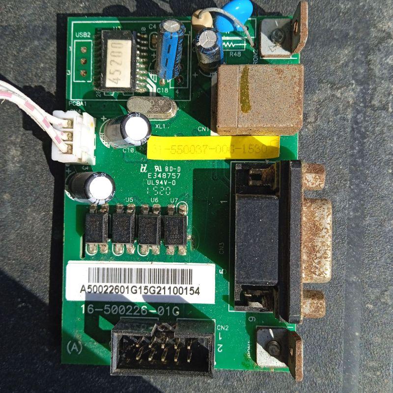

August 21, 20251 yr I try to reactivate this old thread... the rs232/usb board of my old infinisolar 3k plus doesn't work anymore all the rest is fine. As the foto shows the inverter has been exposed the harsh weather of rural Sicily... I need to replace it since I need to urgently adjust parameters. Unless someone another way to access/set parameters? any hint will be useful! r
