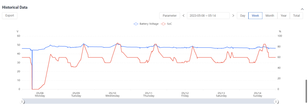

I have the very same problem with one of my AM2 packs. I have 2 in total. The one suspect battery would just drop from 40% to 0. I started noticing that this AM2 was not charging properly. They were also not in sync and no matter what I did, firmware update included, nothing seemed to help. I checked the SOH of the suspect battery and it was showing 53% SOH while the other one is 100% SOH. I have now disconnected the battery and it is going back to Hubble tomorrow for them to have a look at it.
I have the same/similar problem.
My battery voltage "creeps" lower and lower even though there is the same SOC at times.
Monday last week was my "crash" @ 46% SOC. Previously I had one @ 92% SOC and they altered some settings but if I go back, the same slow voltage decay happens over time.
For example,
All at SOC 60% - Static
15 May -  46.3V
14 May - 46.8V
13 May - 47.1 V
12 May - 47.3V
11 May - 47.6V
10 May - 47.9V
9 May - 48.5V
8 May - 46.0V ( Day of last "crash" , just before )

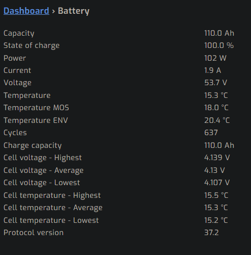

After nearly two years and 635 cycles my single AM-2 has exhibited the exact same behaviour although mine only shuts down at 20% SOC.
This I am convinced by now is a combination of their BMS and Li Protocol.
I have tested so many variations in settings and found that if I disconnect the CAN connection and apply a User mode Voltage control that the battery returns to the intended capacity and voltages.
With Solar Assistant I can still monitor the Inverter and Battery parameters and I can clearly see how the BMS manages the battery charge properly when applying user/voltage control.
This is the state of the BMS controlling the charge right now with the battery just about fully charged and top balancing the cells.
The BMS does a fairly good job controlling the charge, but as soon as the Li Protocol is used the voltages and SOC go out of whack over time.
I am still on the original Firmware and I have set the Bulk and Float to 53,6V. Hubble will probably tell you to set them both to 53,8V, which seems to be their latest advice.
Yes, you have to go to 100% often enough for the BMS to have a reference, otherwise drift like that is expected. It's also required to ensure balancing happens.
I could understand that but previously it was hitting 100% daily and I still had the failure at @ 90% that time. Admittedly since the change I don't think I've hit 100% with the rain and cloud at the moment but there is a mandatory topup to 85% regardless late afternoon.
Then I suggest monitoring individual cell voltages when that happens (with either PBMS tools, or this one: https://github.com/Tertiush/bmspace or solar assistant). I think it's likely a cell that is triggering an undervolt disconnect, but with the tools you should be able to see what the issue is. Actually, with PBMStools, you should just be able to look at the log and see what caused the previous disconnect.

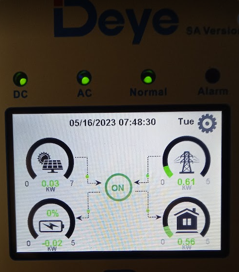

So I had a crash again this morning but now I'm not sure if its the batteries or the inverter or as has been suggested the BMS. Would the BMS alter the state of the SOC vs its own? I would think not. To explain, the batteries dropped from 52% SOC to 0% SOC. Now looking at the batteries , they physically show 2 bars each ( assume 40% - 50% each ) so the battery LED SOC does not match the inverters soc. The inverter now thinks its charging from 0% even though the batteries show the two LED charge. Images below
Battery 1
Battery 2
Inverter
Ignore the time, its the 1 hour ahead issue, this was at 6.48 this morning.
Currently charging as if from zero.
Oh and no faults visible anywhere. Kicked it up to my installer as well to see what the hell is going on. If the serial number is anything to go by, these batteries were manufactured in Feb this year so should be on the latest firmware etc I'd assume but I'm now thinking its either the inverter or something with the canbus between them?

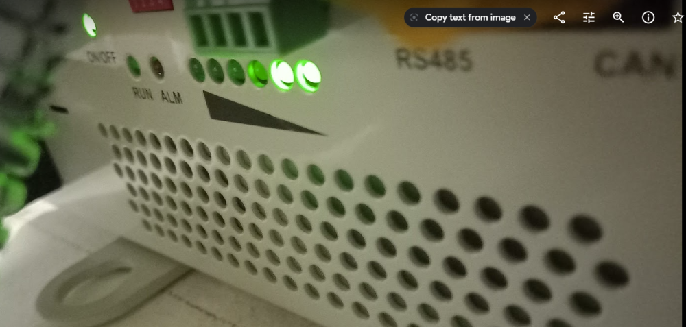

It was a matter of turn everything off - disconnect mains power and battery feed to inverter - and shut everything down. Then a restart managed to restore parity for a short while but after the first cycle, it did the same battery drop thing! :(
I also did a reset using a toothpick on the reset switch next to the dip switches. This corrected things briefly, but then the problem reappeared.

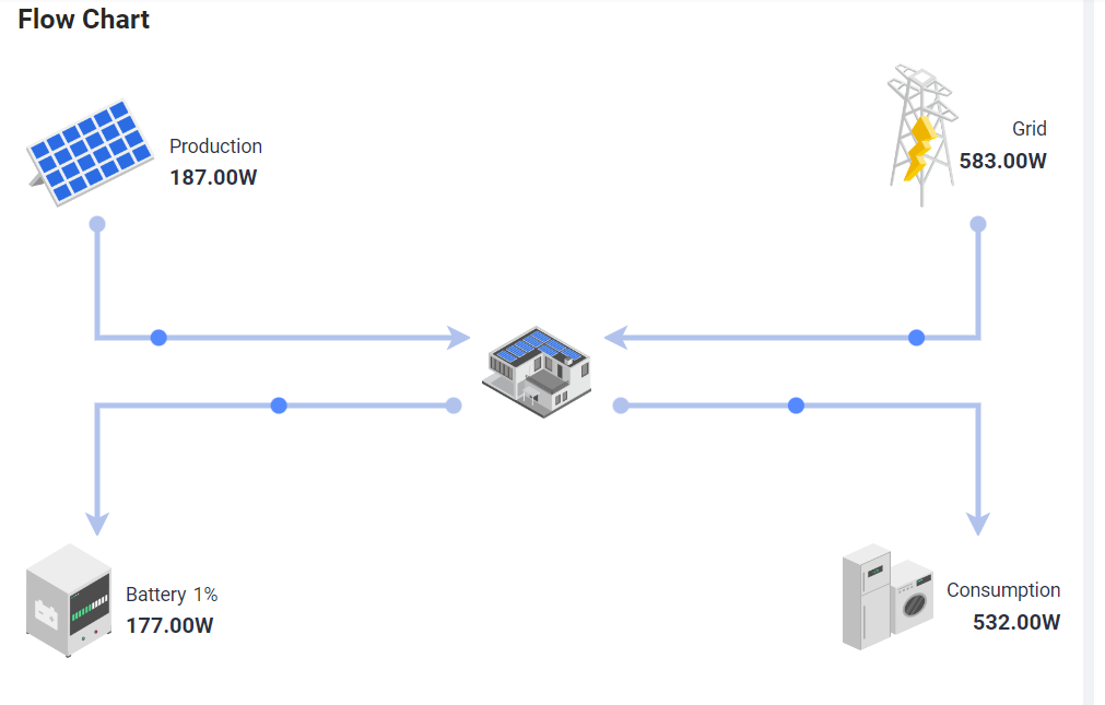

I have the same issue om my Hubble AM-5 battery, SOC just drops from 32% to 0%. This morning again from 41% to 0%. I think what is happening is that the battery BMS is overestimating the SOC. So the BMS reports 41%, but in the mean time the battery is actually at 0%. It slowly drifts over time, so after a good charge from 0% all is well for a while, but over time the difference widens again until it "crashes". I am now running the battery without the BMS cable connected as an experiment. The inverter will now manage the SOC. Will see how that goes.
What is super interesting, after unplugging the BMS cable, the SOC dropped instantly on my inverter display from 60% to 36%. So the battery BMS thought the batter was at 60%, but my inverter thinks it is at 36%, this is consistent with my above theory.
