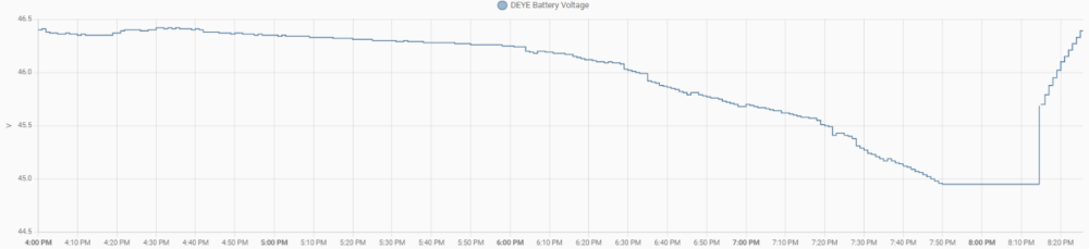

My Hubble dropped for the second time from 30% to 0%. The first time I let it go, but now the second time I'm getting concerned. Has anyone else have this issue? See my graphs attached. Load shedding started at 6pm, then the discharge started.
I'm not too happy with this Hubble battery. (I've had the state of charge % showing wrong on the inverter. It's still showing wrong when I directly connect the battery BMS to the inverter, but via their CloudLink box it seems to work, but then the battery temperature is -100°C. )

To me it seems like a BMS disconnecting due to 1 cell being at a too low voltage.
Have you looked at the different cell voltages at the point of disconnect.

If you zoomed in on the graphs, then the SOC and V values would be easier to see. But if your cut off voltage is set to 44V, then the shutdown seems to act accordingly.

Post the Battery Voltage graph for the time

So this all looks like a mal function of something. At the 35A discharge current it cannot get to zero SOC in the few minutes. Further it cannot be charged back to 100% again in minutes.
12 hours ago, PsyWulf said:
Looks like you have a weak cell or another critical fault since the voltage doesn't correlate with the SOC cascade
I still feel with the bat voltage and bat current in line with each other the SOC reading was just a false reading for an unknown reason.
This is probably the answer. I think there is an issue with the balancing in some firmware versions, and this battery probably never got balanced, though that's just speculation. It could also be one of many other issues, like the welds holding the cell terminals to the busbars cracking, essentially becoming a "dry joint".
