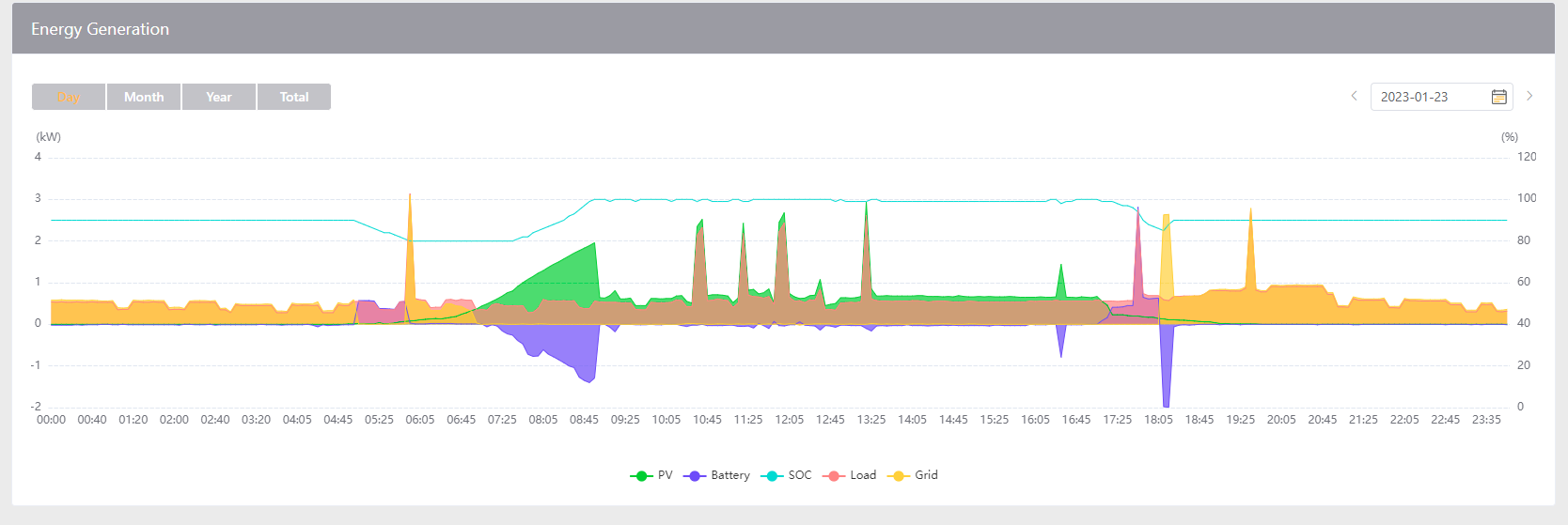

I have my whole house on the SunSynk EXCEPT: Stove, oven, pool pump and geyser.
4 bedroom house, 2 kids:
Average general consumption hovers between 400 - 700Wh. So with that, I get 9 to 11 hours without the sun. However, I do boil kettle, use microwave and air fryer for breakfast/dinner times, so that can consume.
During the day with sun - easy the whole house, including fans, dishwasher, washing machine, iron - no problems.
Here is an average day usage (yesterday).
